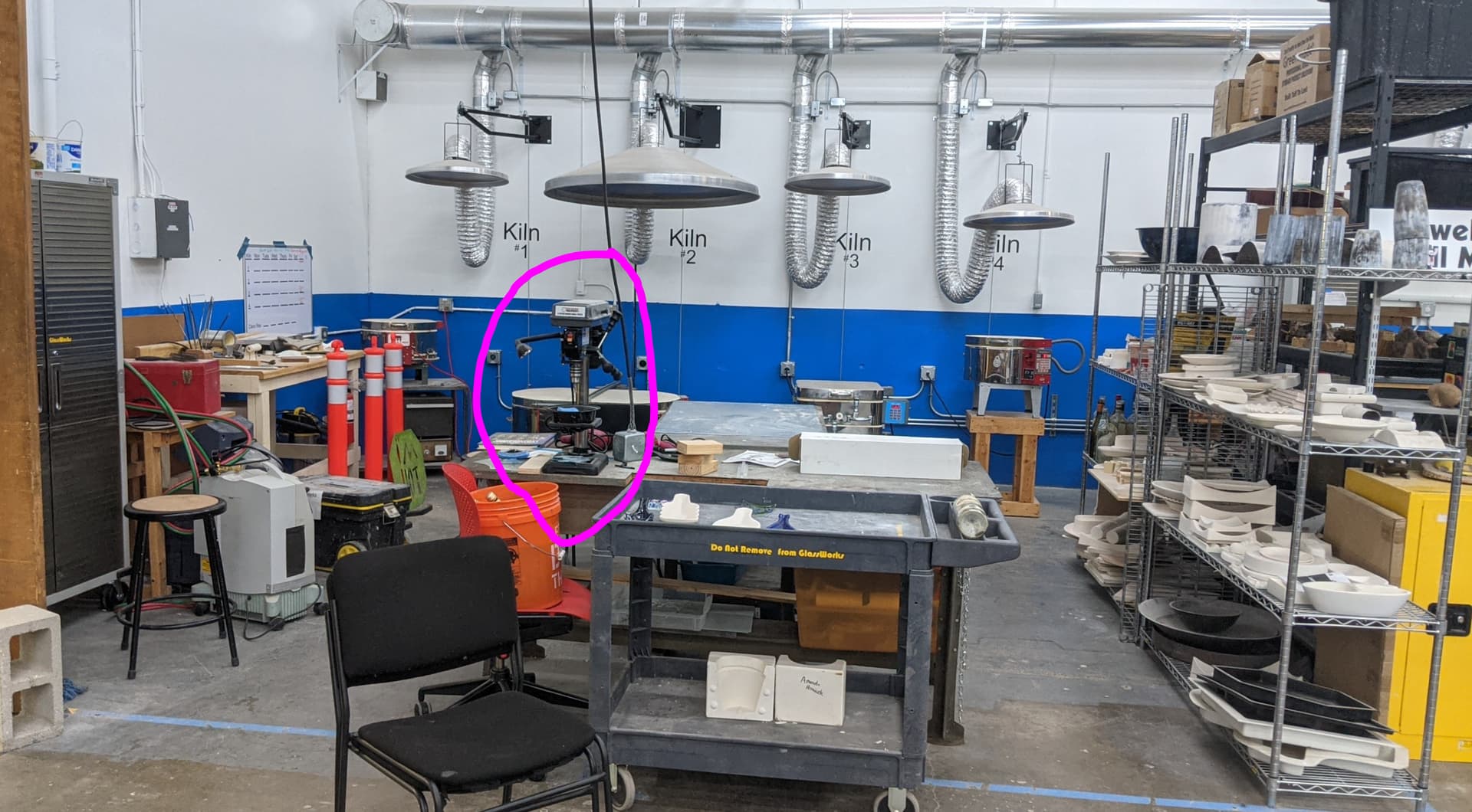

You might want to use the drill press in Glass Works instead. Mind you, we only use wet sponges to get the water to cool the stone/glass/whatever.
This one? I found this picture on talk:
I would be fine with that. It’s a little small but I could figure out a way to support the slab and make it work
