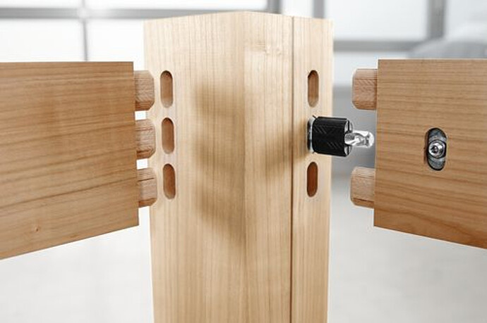

In that case, have you considered knockdown hardware?
Festool 203420 Domino Connector Corner Set EV/32-Set (32-Pack) Amazon.com
Or
FarBoat 4Sets Bed Hinges Bed Rail Brackets 3.1" Double Hooks Heavy Duty Iron Replacement Part for Bed Frames Headboard Footboard with Screws(80mm/3.1inch) Amazon.com
Yes indeed, I am planning to use that hardware for the rail to bed post joint!
Will still need some traditional dominoes too though for the footboard and headboard construction.
Going to be a big build, hope I survive :joy:
How many of the Festool anchor bolts are you planning to use? 2 per rail end == 4 per rail; 2 rails == 8 total?
Just one per rail end. I’ve done that on a queen bed in the past with success. Using 2 additional dominoes on each rail end glued into the rail for strength and support
Very similar setup to this
