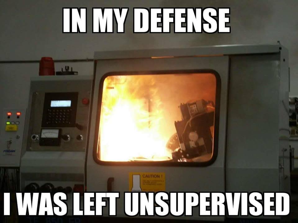

Domino gone completely wrong
…Or why we don’t cut magnesium.
Why we don’t machine magnesium.
Spoil sports! :blankspace:
