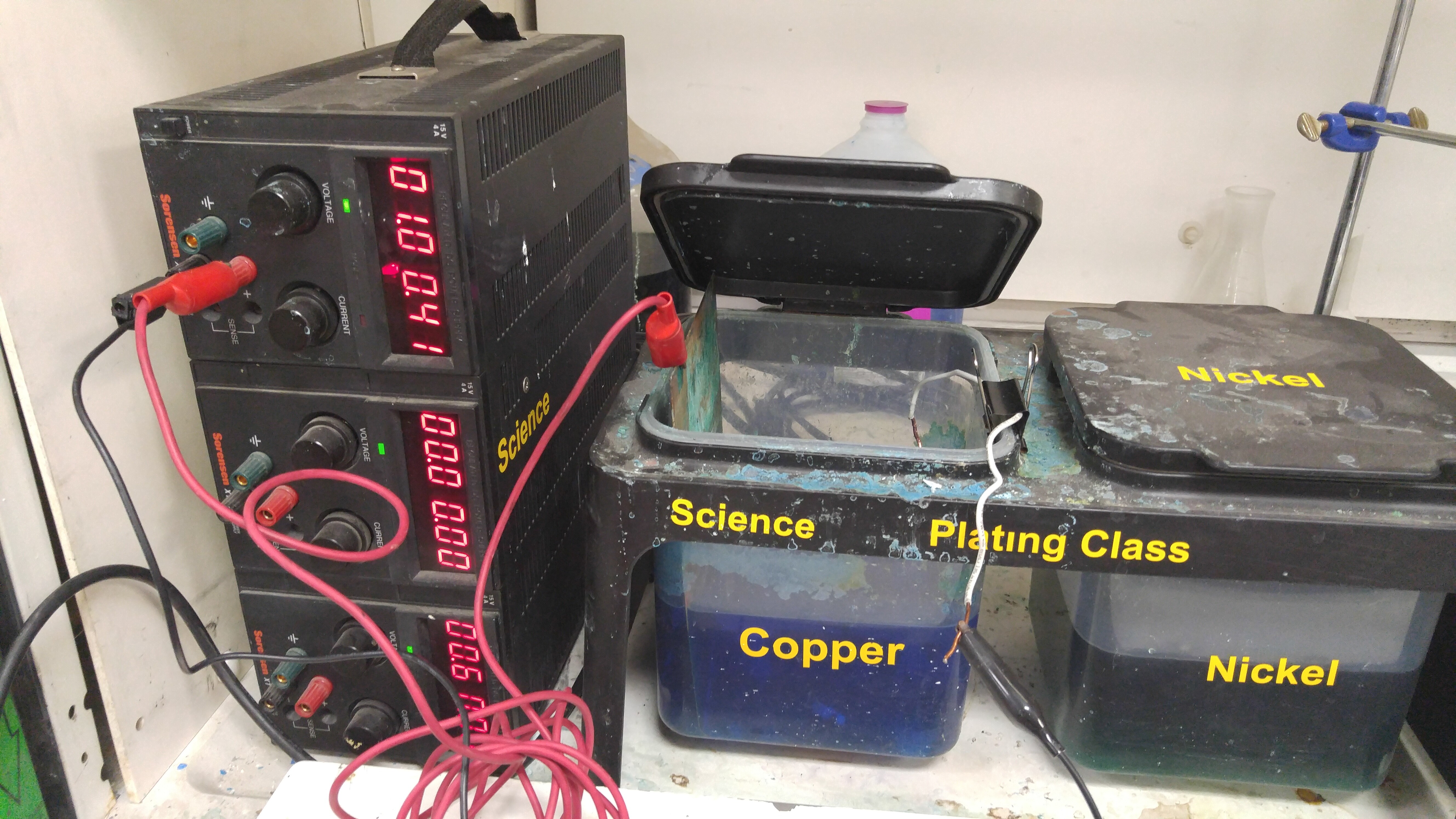

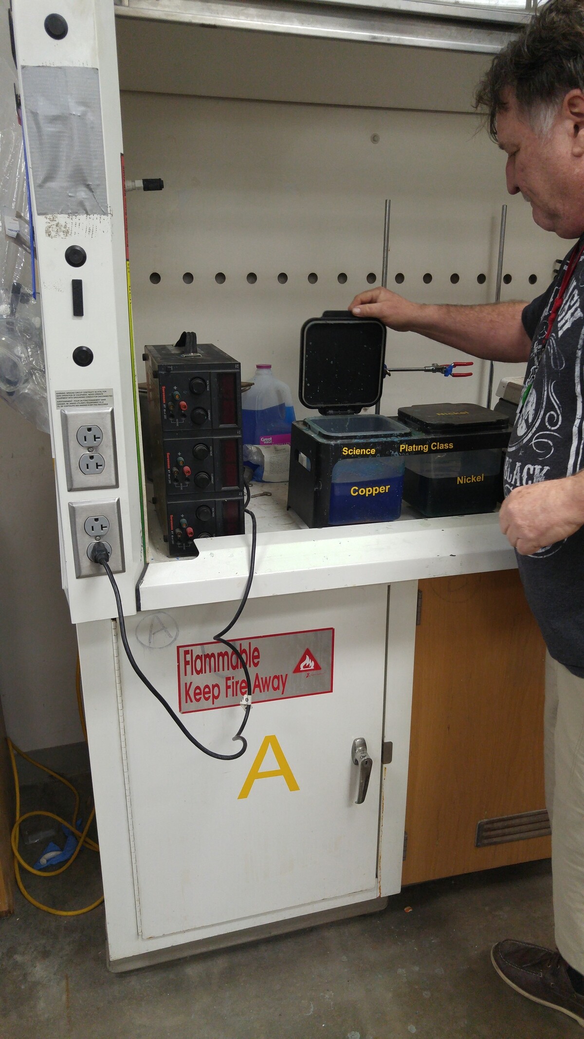

Surface preparation and cleaning are crucial to the quality of chemical finishing. So is maintaining the chemical balance of an uncontaminated plating solution - repeated use changes the balance of the complexing agent as the metal content diminishes in the bath. If you plan to do any chemical surface finishing I would strongly urge you to buy your own cleaning and plating solutions because in my experience the community resources are not pristine enough for a good finish. That’s just the nature of community resources. The nickel plating I have seen coming out of the science plating baths looked more like flocking than plating.
And of course you would also have to take every last bit of the chemicals with you and find the proper way to dispose of them. You shouldn’t even rinse your parts or your containers in the sink; the metal effluent is toxic.
