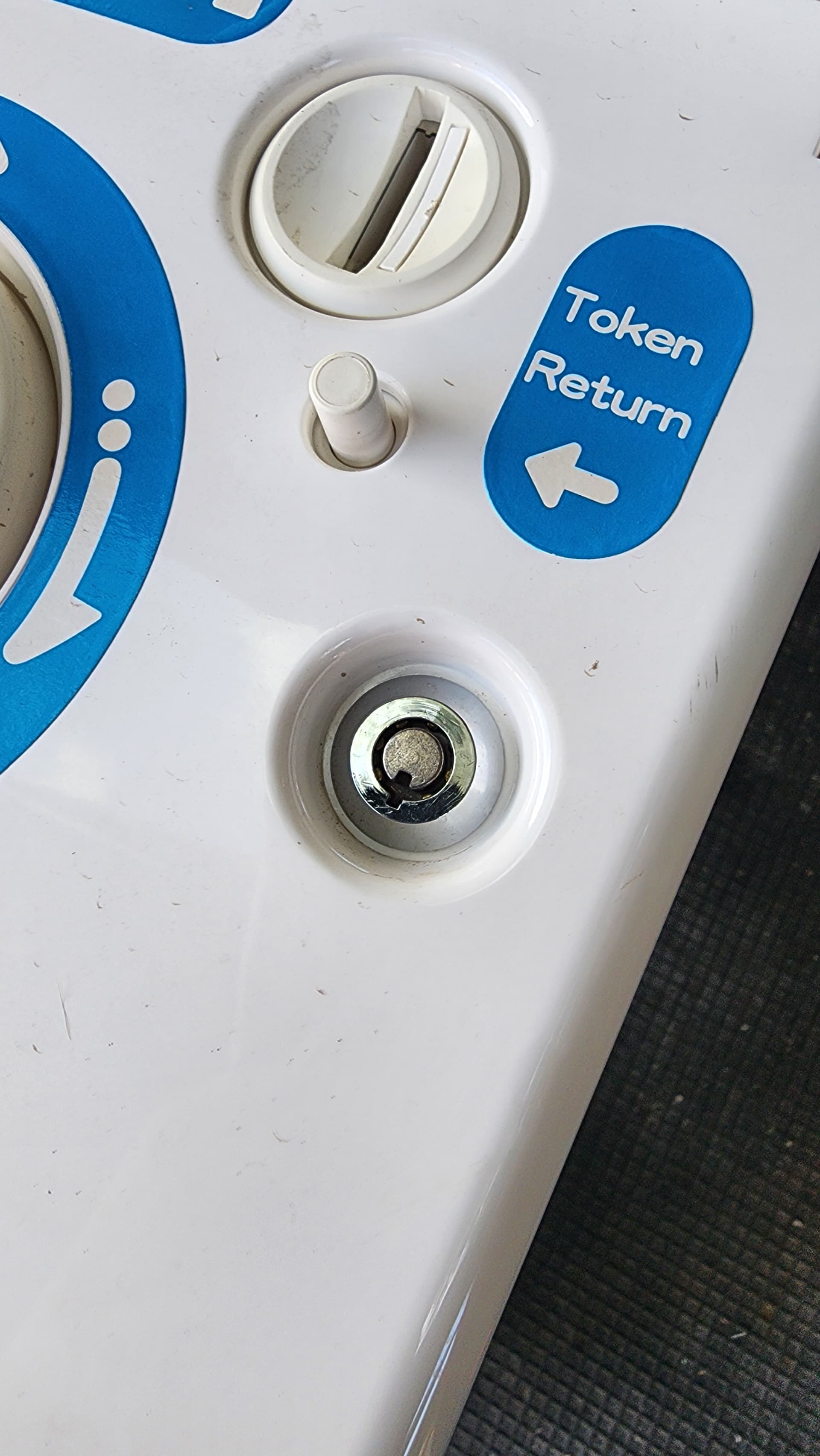

I recently bought a used vending machine that did not come with a key. Im trying to open it to replace the lock.
Does anyone have experience picking a tubular lock or have have a picking set i could borrow? Thank You!

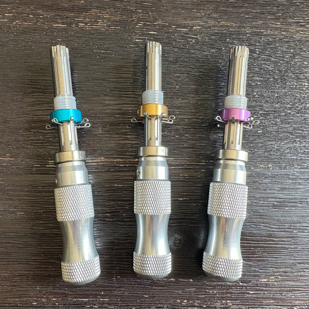

I do! I have a couple of 7-pin tubular picks and a fair amount of experience with them. Where is the machine living these days?
Its portable and in the back of my car. I can bring it to the space. I have 4 that i could use some help on. Are you available any time this week?
Sure! Daytimes are best for me, but I can do morning or afternoon pretty much any day of the week - just let me know what’s good! Are the other three machines tubular locks as well?

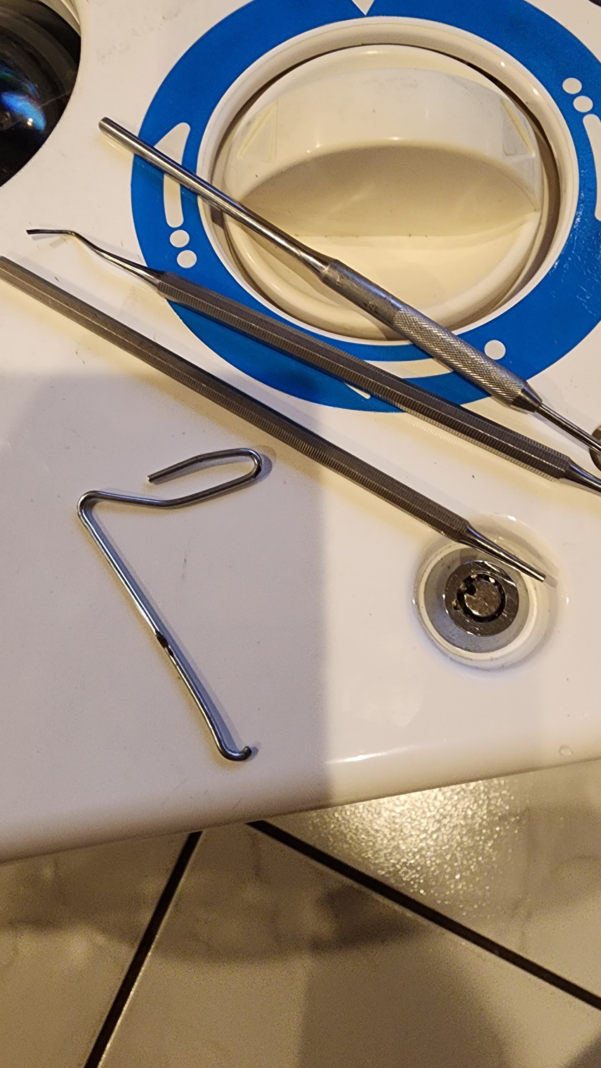

Struggle a bit but was able to pick the lock with some dental tools. Thank you for offering help!
