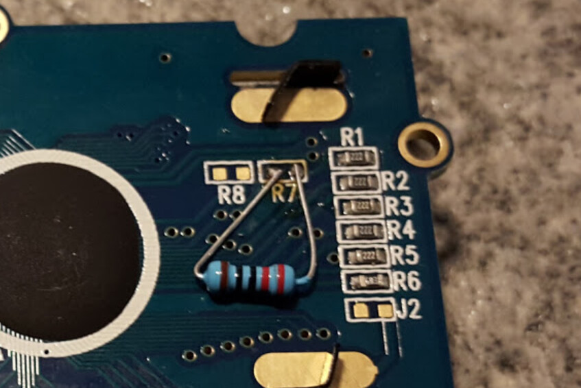

I know that you’re probably knowledgeable enough to know this but for anyone else reading. In a pinch if we don’t have any, it’s relatively easy to bodge in a through hole resistor on 0603 pads by looping it back on itself or lying it on it’s side and then running the leads to the pads. Hot glue can stabilize it pretty well to keep it from tearing the pads out or moving around.
Random image found on the internet of the practice.

Yeah that’s what ima do if I can’t find an SMT part. Thanks!
