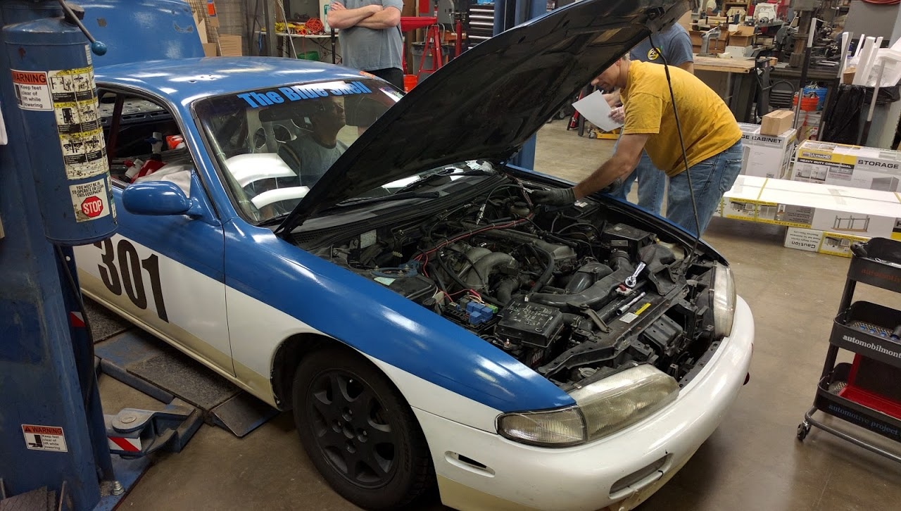

Will be meeting this Thursday at 7:30 to move the car and start looking for any worn / needs replacing / damaged parts.
We got the car back to DMS, it started up first crank from it’s home at offsite storage.
The compression check got 187, 170, 163, 183 on the cylinders, which sounds pretty good, so we will only be replacing the valve stem seals (without pulling head) to see if that solves the oil burning problem.

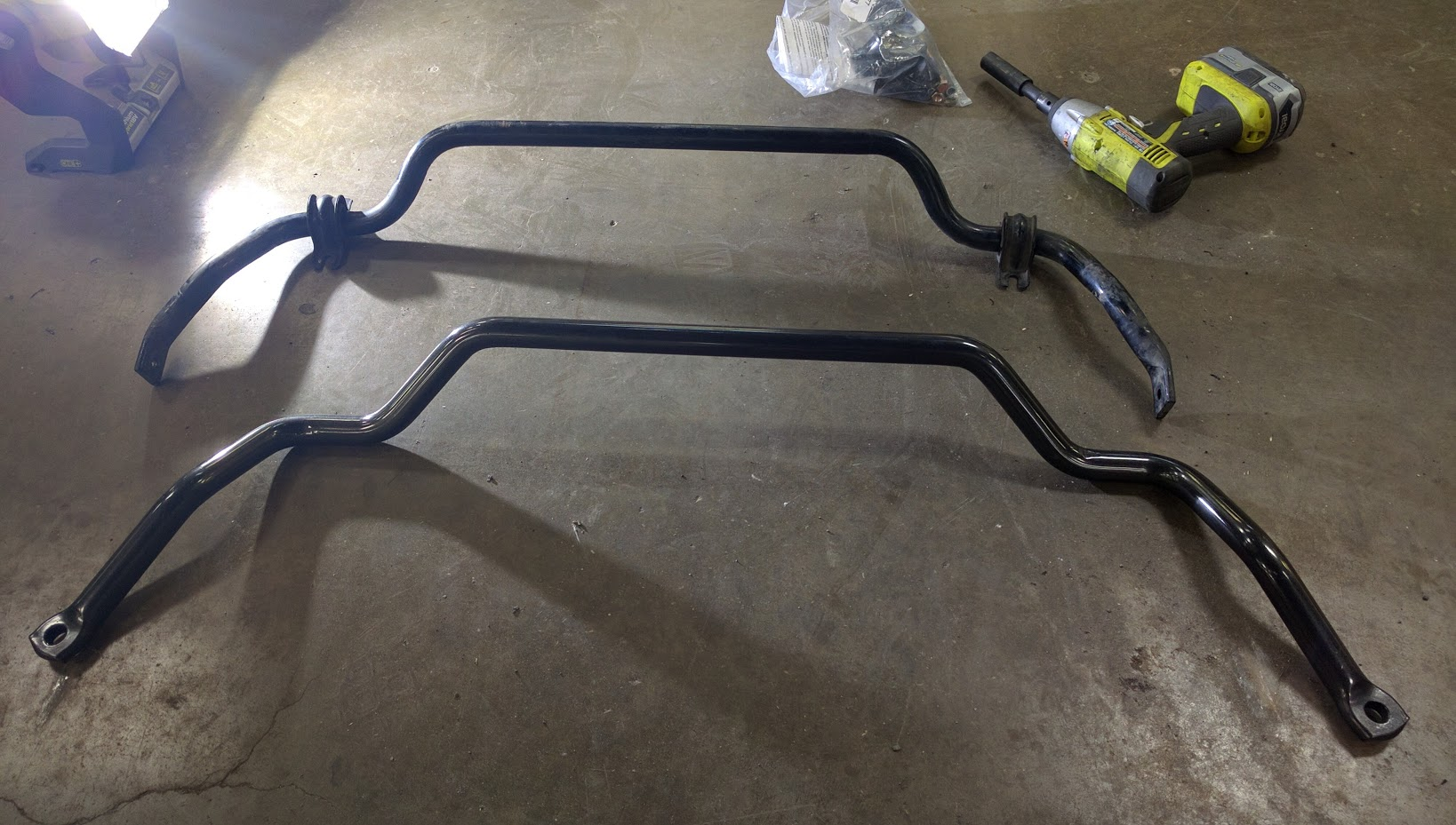

Out base model 240sx didn’t come with a rear swaybar, (the SE model came with a 15mm rear, both have 27mm front bar), so we will start looking around junkyards for a 240sx SE so we can get its swaybar for cheap or potentially just order aftermarket swaybars (questionable quality items can be found for cheap on ebay)

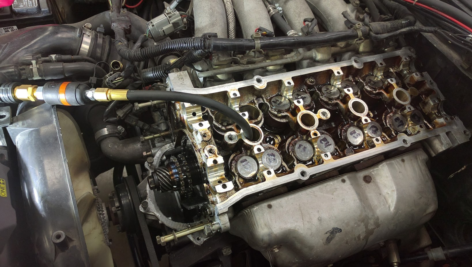

Will be meeting saturday 1pm to work on replacing the valve stem seals (parts wont be here until friday), I ordered the tools to use the method shown here to replace the valve stem seals. (Except to use compressed air and not a rope stuffed into cylinder to hold valves up…)
I forgot to mention in last post that anyone is welcome to come help with the car or check it out, we unfortunately have a very limited number of driver spots for this race, but there are lots of things to work on and learn from.

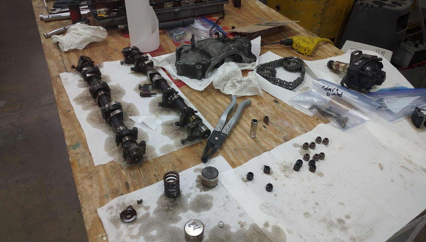

We successfully replaced the valve stem seals without pulling the head, and it looks like we fixed the oil leak.
We were careful to be sure to mark the distributor and upper timing chain and sprockets to be certain we could reassemble everything correctly.
I did mess up by forgetting to put the car back in gear before applying the air pressure to the cylinder to hold the valves up. Since we didn’t have a regulator we were putting ~110psi into the cylinder, which is >500 pounds of force, which spun the crankshaft some. This cost us extra time when reassembling the upper timing chain to be sure we got everything lined up with cylinder 1 back at TDC.

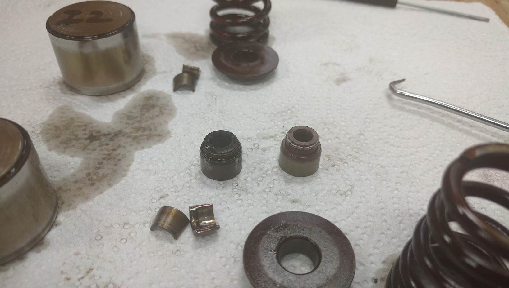

The old seals were rock hard and clearly not good:

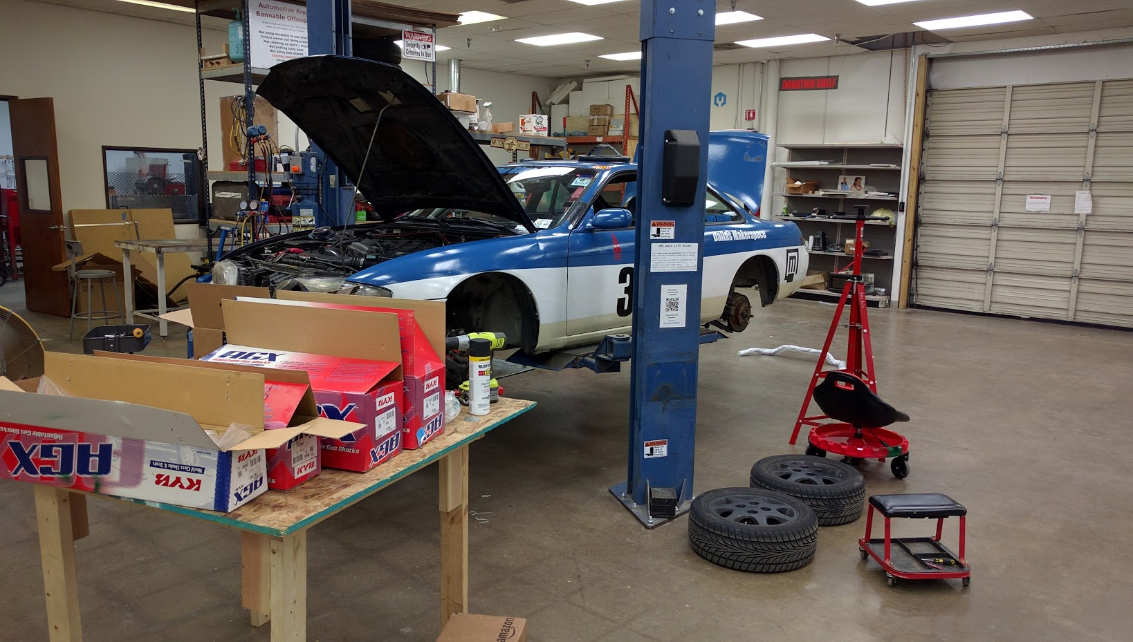

Will be starting the swaybar and shock install this saturday around 1pm if anyone would like to help.
Got the shocks / swaybars installed
Front bar, OE was 27mm hollow, to a 28mm solid
