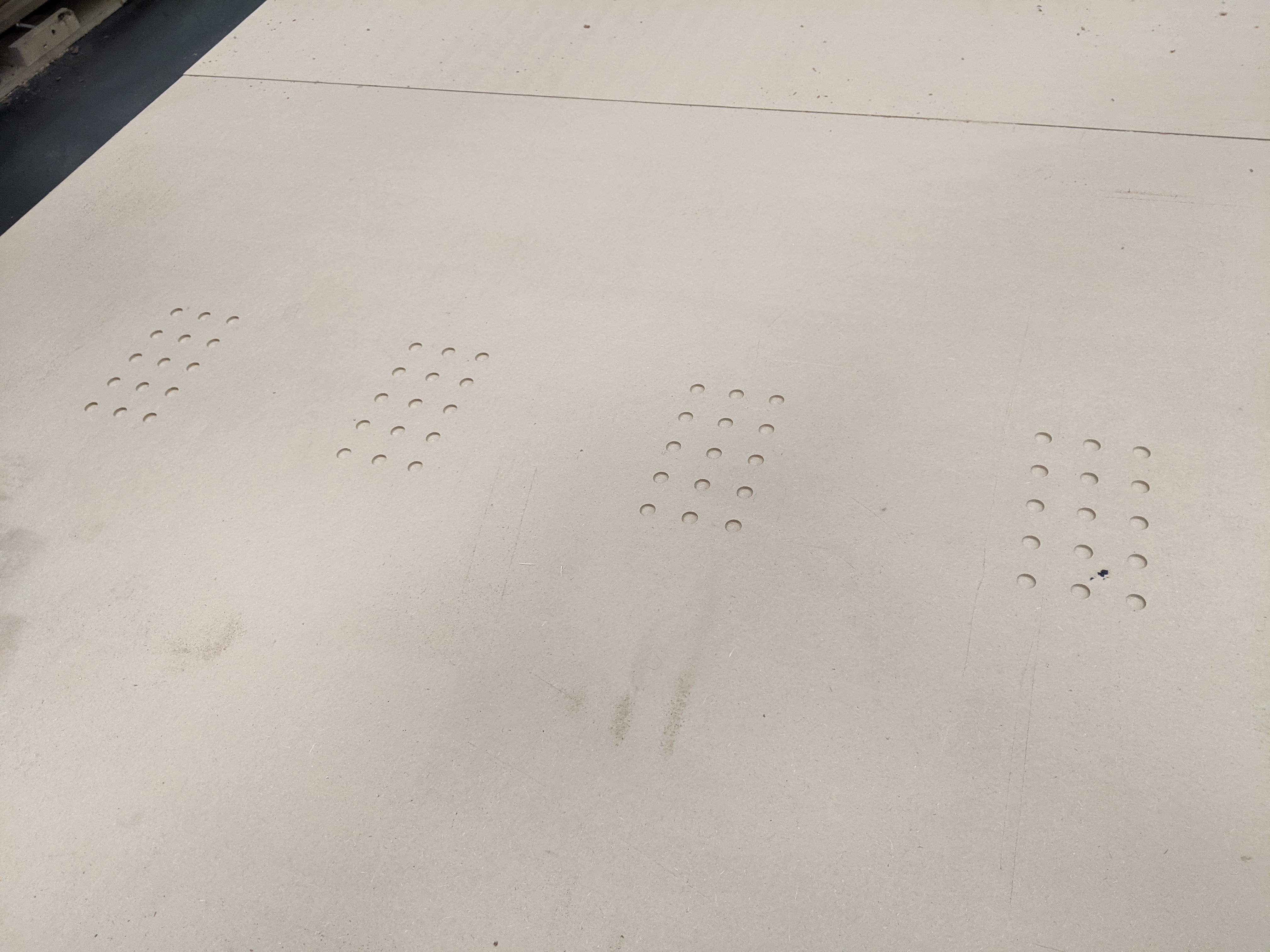

To the person who made no attempt to repair and failed to report the damage you did to zone 6…

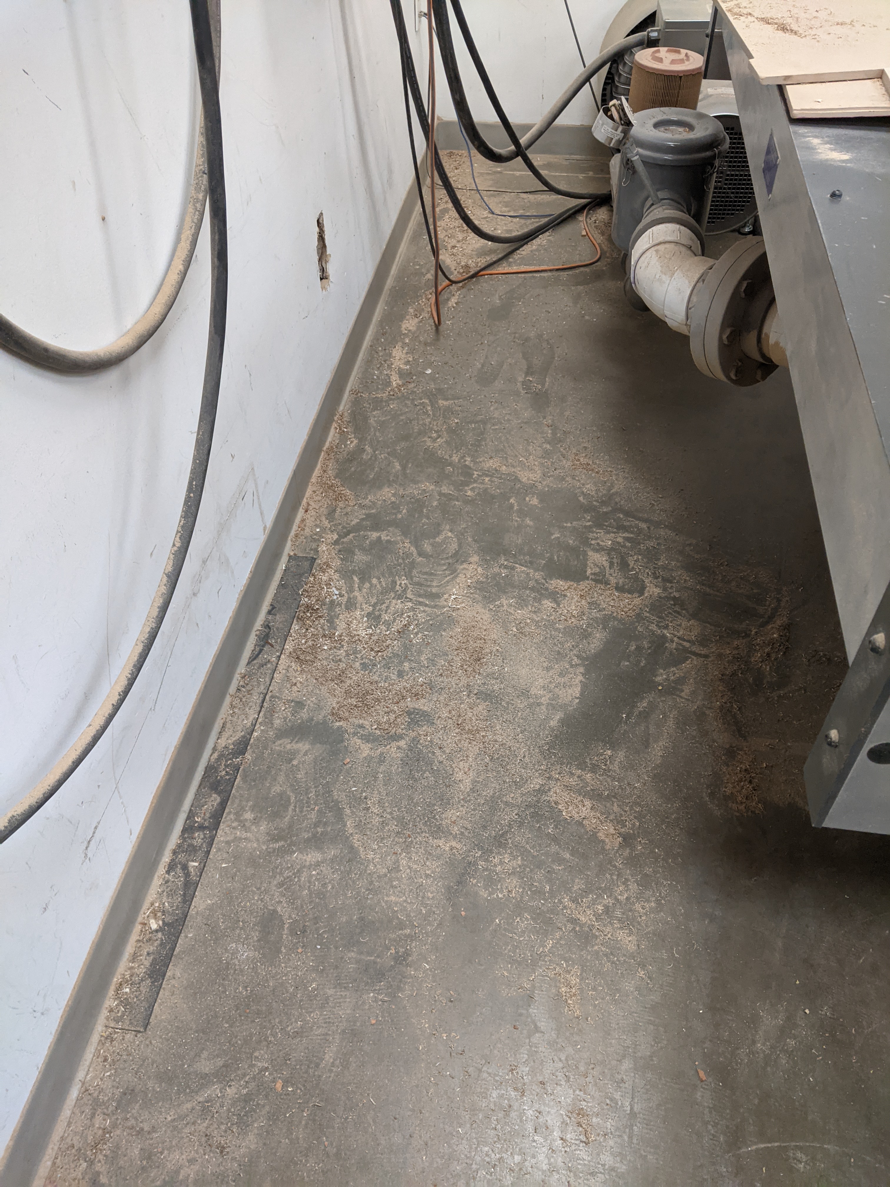

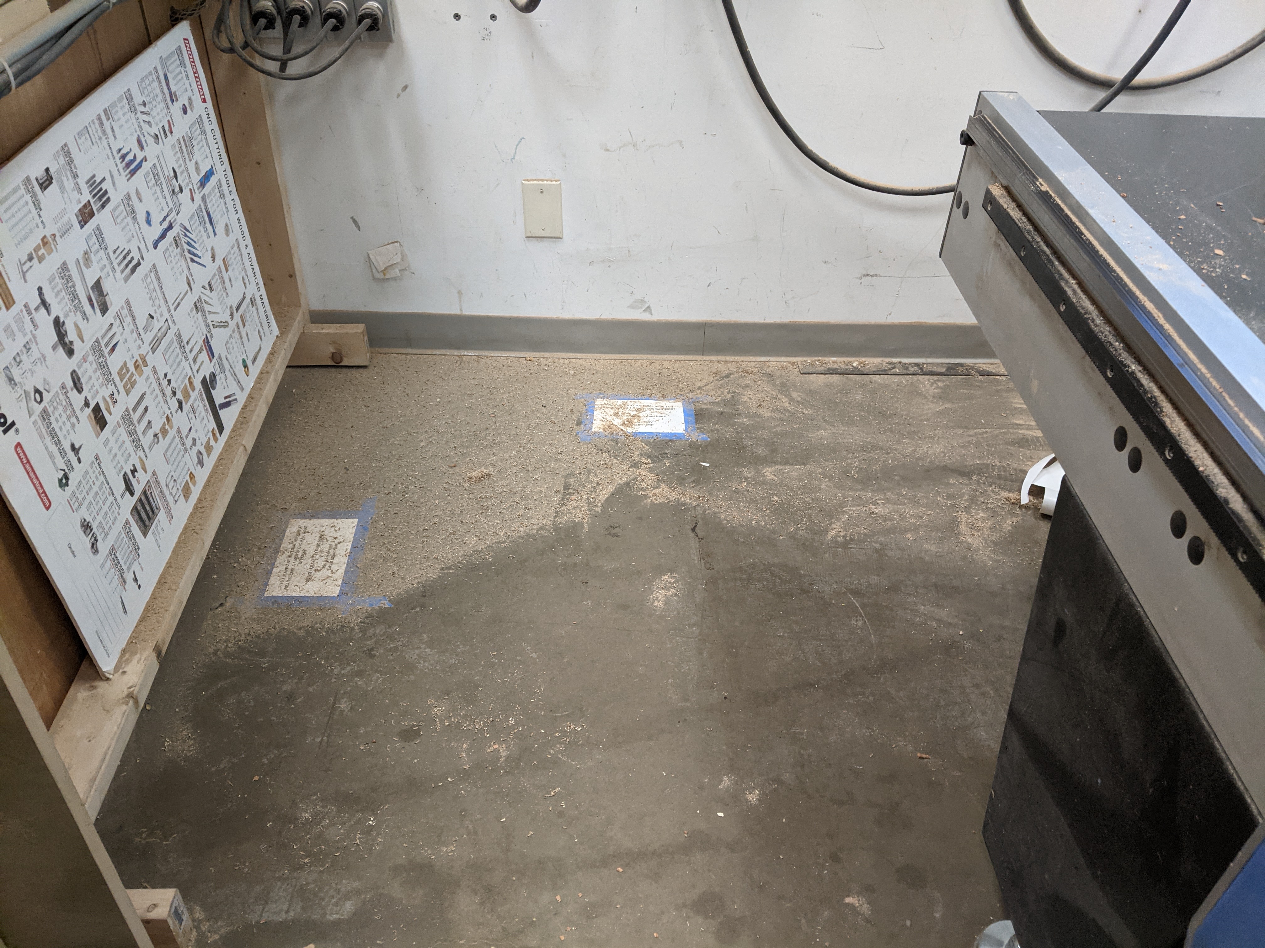

…and left a mess behind the machine…
…you owe DMS an hour of time.

We need to get sacrificial spoil boards implemented or the gcode precheck for max cutting depth written. Precheck would move head to xy close to front of machine and perfom drill operation to top of spoil board, Run precheck before your first step, if the bit hits the spoil board you probably missed top of spoil board setting. But damage to spoil board is only a hole in an area we don’t use anyway. Ideally log the userid logged into the machine and job name so we can track if precheck was skipped.

In an area who doesn’t use? I’ve used that area before.
This. In the very near future there will be a requirement that no cutting be done directly on the machine vacuum boards. They will only be used to hold down your own sled/jig/board to which your work is attached. This uneven/damaged table stuff needs to stop.
It may be worth adding something to the Multicam training and check-out covering the specifics and mechanics of spoil board repair process, if not already incorporated.
It pains me that we have to add extra steps and make it more difficult for users that are not having creating this issue. It seems like we should be asking those that continue this issue to fix it or retrain. I think some of the cuts in the spoil board would have easily cut through any sacrificial spoil board and into the existing.

Speculating is not necessary. A non-zero number of people have cut into the bed.
