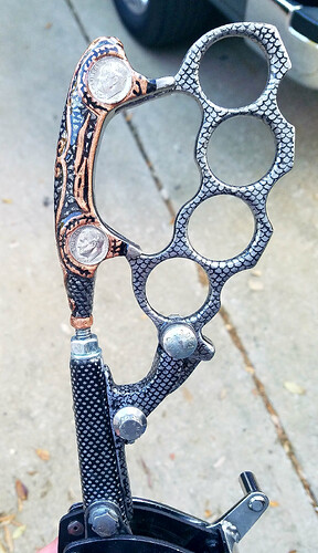

ABS seems like the most appropriate material to me considering the original is plastic and an aluminum blank that size would most likely be completely cost prohibitive. I think (could very easily be wrong) that even the grill on that '68 is plastic but with a chrom-ish type front face. I know they sell “billet” grills, but I’m going for something different - something I haven’t seen yet on a 1st gen. I’m trying to figure out feasibility right now - if this thought turns out to be too difficult I’ll go back to my original thought and start working on an active aero design. All that being said, I’m new to MS and getting frustrated already with how difficult it is to find info (admittedly I’m horrible at asking for help and working on that part) and the lack of class availability to get trained on something so I actually have a reason to come out to the location. I’m not sure that I’d say I’m skilled in metal or just tenacious but the shifter below I hand made from a brake rotor recently so I do intend to spend time in the metal shop (specifically for plasma cnc and to figure out tig welding aluminum) - is there anything in metals that you don’t first need training on? To be clear, I’m happy to take the classes - they’re just always full or not scheduled… Same thing for machining - I started the HAAS course, but it’s clear that will be a more long term deal. I have tons of different projects I want to do, but getting access is… meh, realize I just took a left turn somewhere and this post is not so much related to this thread - my bad.
Here - enjoy a pic of the first part I didn’t purchase for my 67 :smiley: Thanks guys, I appreciate your help!

Nice work!

I hope we’re able to bring you some joy on those things that brought you to Makerspace. It’s a cool place, where you can make more cool stuff (out of brake rotors, if you like) like that shifter. Very nice! I’d like to hear more about how it was done. :+1:
