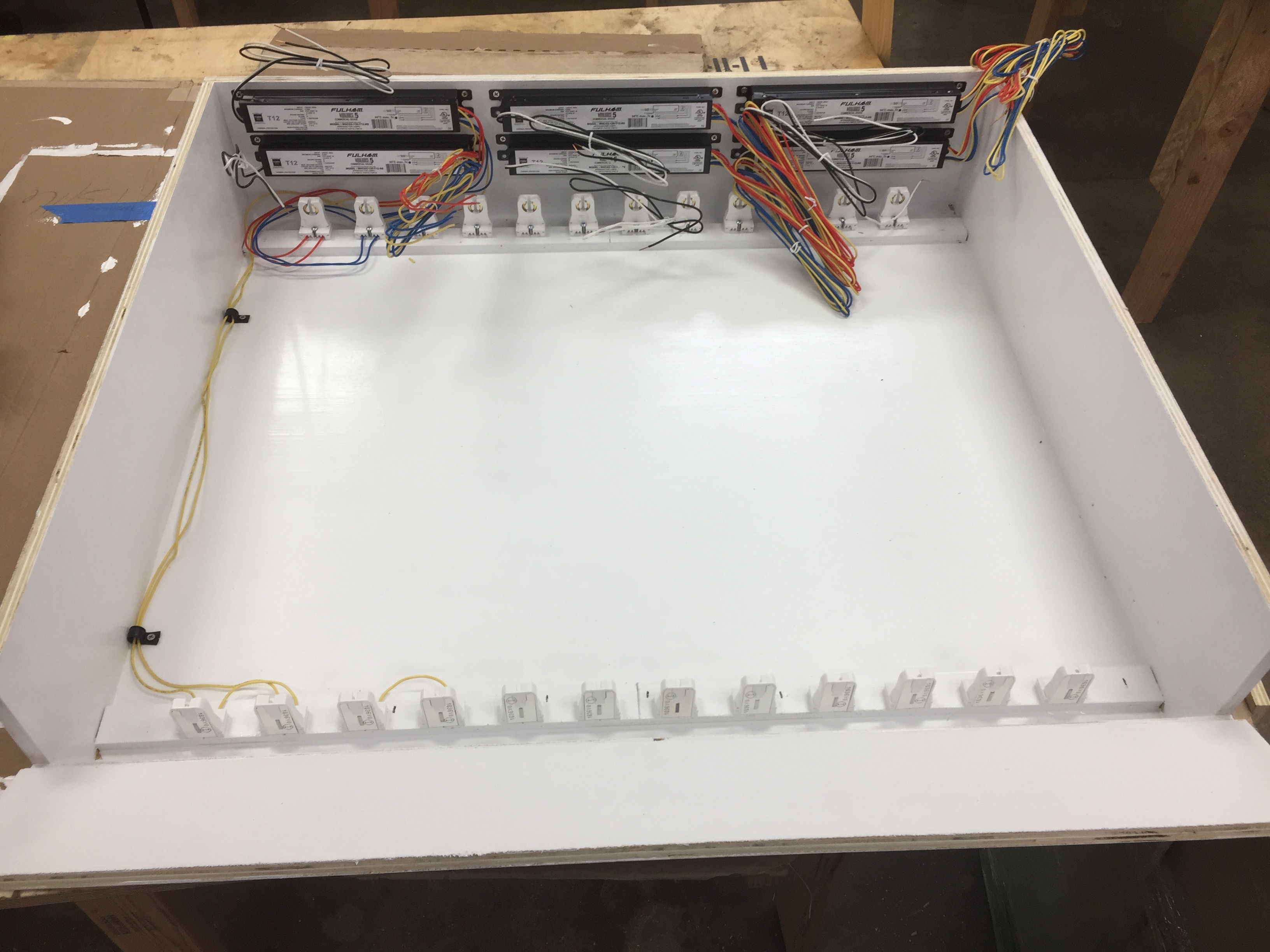

How large a print would you think? Eventually I would like to do 20"x30" but will start smaller since the cost per print is pretty high and this will definitely be a learning process for me. These are simple to build and I can pick up the supplies this week. I probably need to draw something up and make sure some committee will provide space for it. I’m building one regardless but size will be limited if I’m hauling it back and forth. I built a 12"x16" contact print frame for 11"x15" paper today.
If we can’t keep it at the space I will build a UV box with 24" bulbs. I think 16x20 will be the largest possible print but its a start and will still be fun to try.

I’m in town this weekend so if I can figure out the ballast and bulbs by then I want to finish the UV box by Sunday. @lampy may have some thoughts on this. I think the easiest would be T8 ballast and BLB bulbs.
Well, I finally made time to start building the uv box. Almost complete it this weekend.
Well time fly’s when you bounce from hobby to hobby. I finally wired this thing last night and found paper and transparencies locally, Asel art supply right down the street from me. Now I just need to find the cheaper cyanotype or van dyke chemicals so I can test. If anyone has some laying around they want to sell I’m buying! Or if you want to get together and play around with it. I am ordering chemicals online but I have this weekend free if I can find it locally. After that I’m out of town for a bit.
