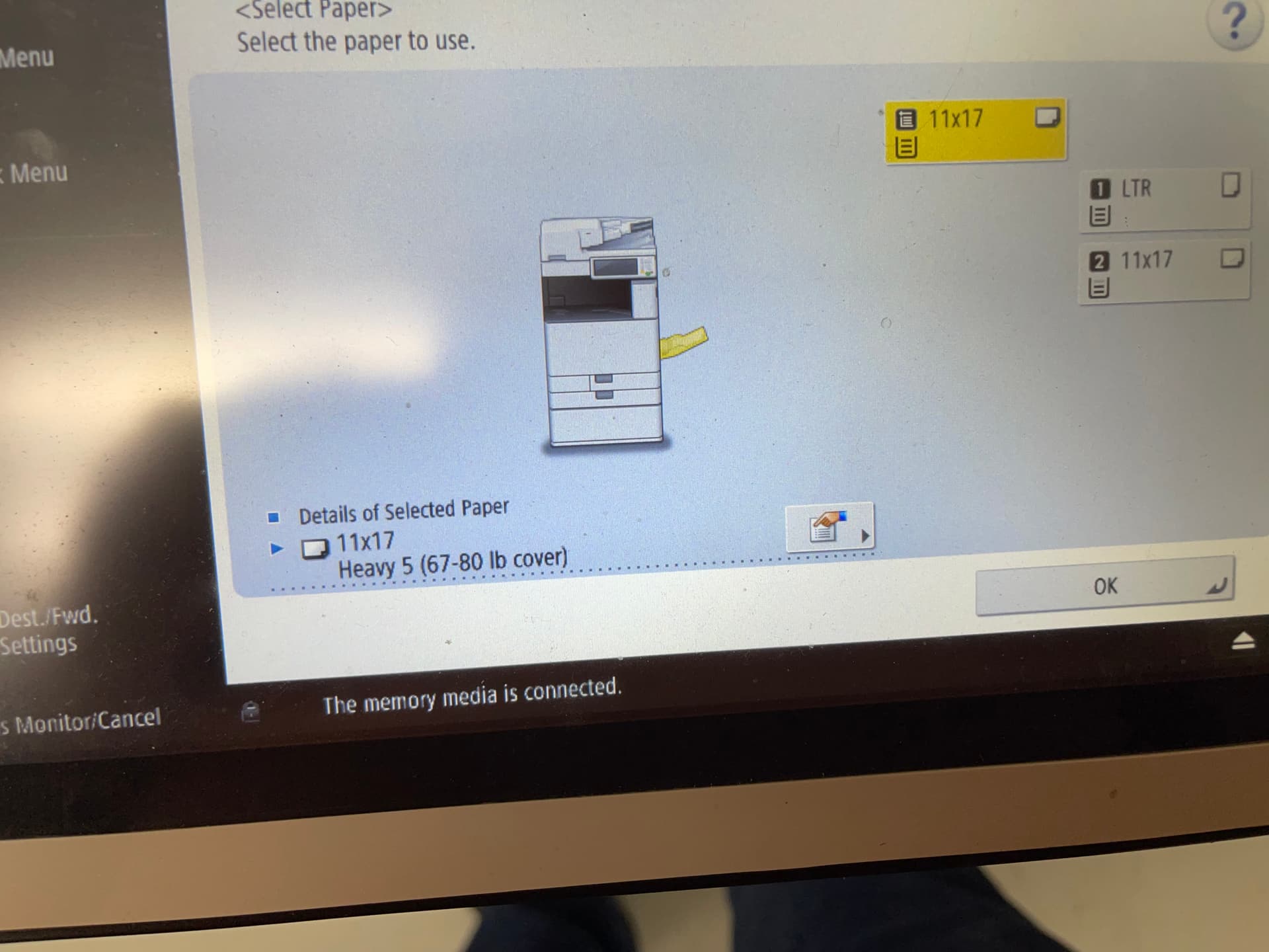

I was having trouble with this as well, and discovered the magic spell (menu actually) required to make this work. It’s nowhere in the official ‘documentation’ :nauseated_face: I’ve found, but it’s the difference between perfect copies and flaking toner. I’ll try and take notes when I’m in Thursday.

Doesn’t seem to be needed once the correct paper is selected. I’ll document it Thursday Grab me if you are around.

When you load stock in the side tray, this screen pops up:
If you select change, you get this:
The yellow highlight is the indication that I selected “Heavy 5” (67-80 lb card stock) Once it’s selected, you get this:
HINT 1: if you do more than 10 sheets or so of card stock, I suggest you do them in batches. I had good reliability feeding 10 sheets, some issues with stacking 15.
HINT 2: Make sure the stock you add gets under the keeper fingers on the side guides of the manual tray.
HINT 3: If the feeder runs out of paper it resets to the default stock (17-20 lb bond.) If you have a few extra sheets in the feeder, it will not reset and you can continue to add stock. .
