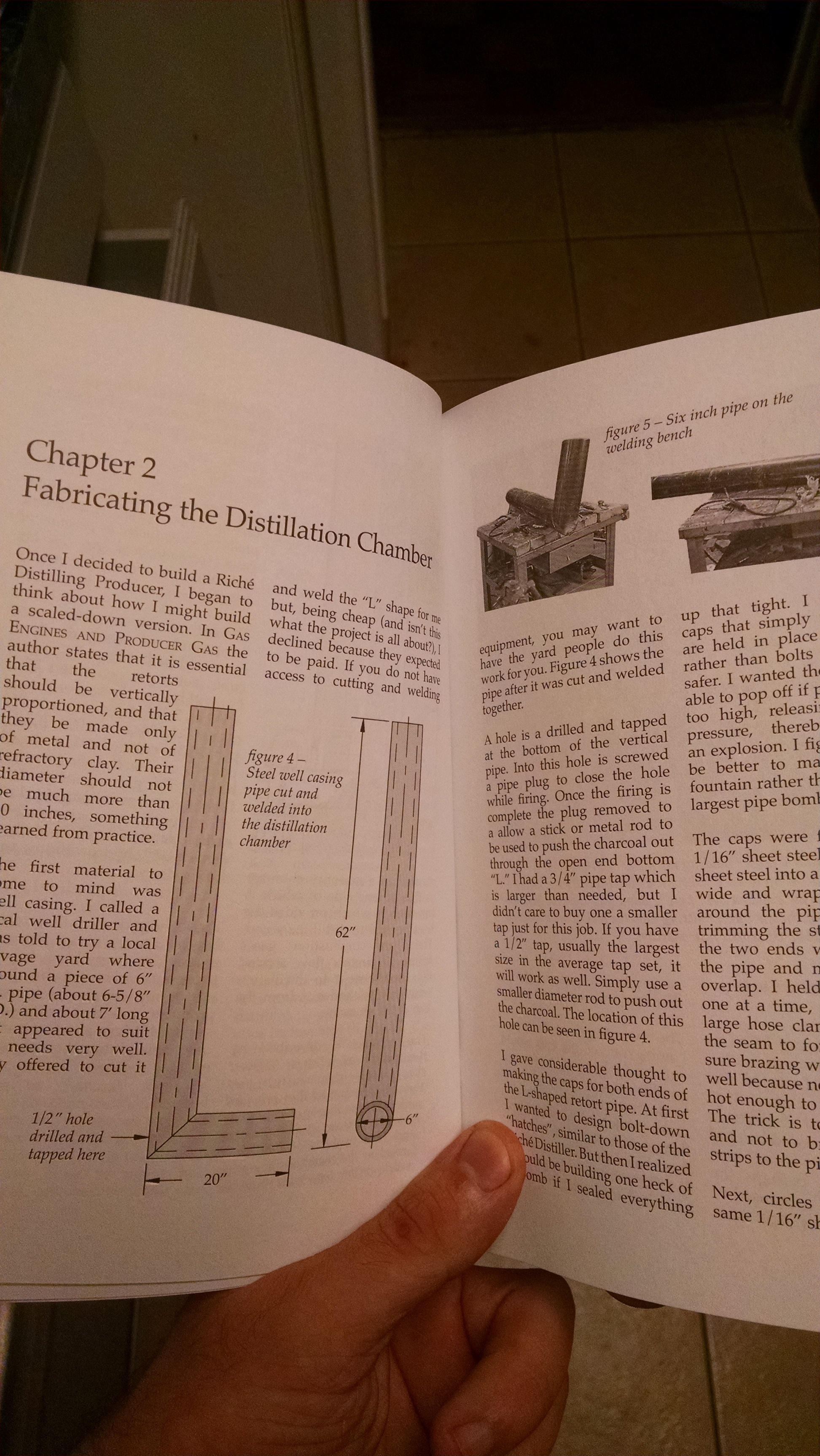

I’ve heard of designs which gassify part of the wood and then burn that to heat the rest of the wood in an oxygen-poor environment to make charcoal. Anyone know the magic form and dimensions for something like that?
We use TLUD (top lit updraft) for charcoal making. And actually want some residual tars/minerals for certain effects.
I have plans.
Give me metal and a means by which to fuse it and I will build the world.
