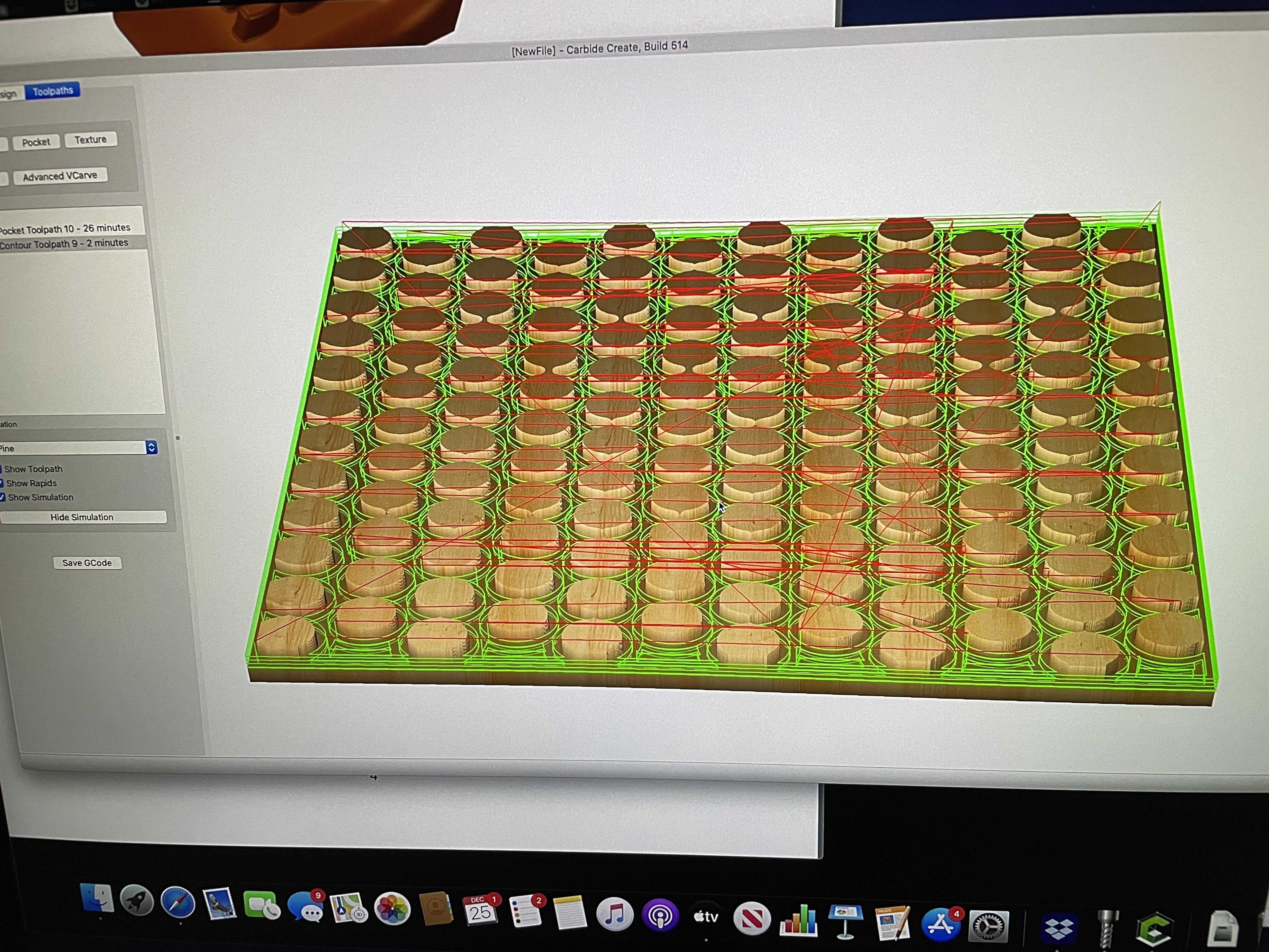

Hi Hanna, thanks so much! I have this mockup that I did in Carbide Create but it would probably need some iteration. I can describe in more detail but its essentially a grid for cap art that I’m creating so I’m basically trying to create raised bumps on a flat surface kind of like the top of a lego brick. then I would glue the caps on to the raised equidistant bumps. Let me know if this image does not come through. Newbie in the forum here!
This is doable on the CNC… but it isn’t the tool I would use for this. Lots of machining time and waste material. Cutting a dowel in to cookies for the pedestals and gluing, gluing the caps on the flat, or CNC cutting smaller recessed circles for the cap edges.
Looks like you should use a smaller tool for the job, it looks like the circles aren’t being cut fully (which makes me think they may not be laid out evenly).
No reason to avoid CNC. Pretty sure it would be safer & faster than cutting thin dowel pieces and gluing them into the correct position. Hopefully @Hanna_Kessler will be able to adjust the layout and pick proper bits for the task. Of course the wild card at DMS seems to be access. The faster part assumes you can get Multicam access in a reasonable period of time. Feel free to reach out if you or Hanna have questions.
