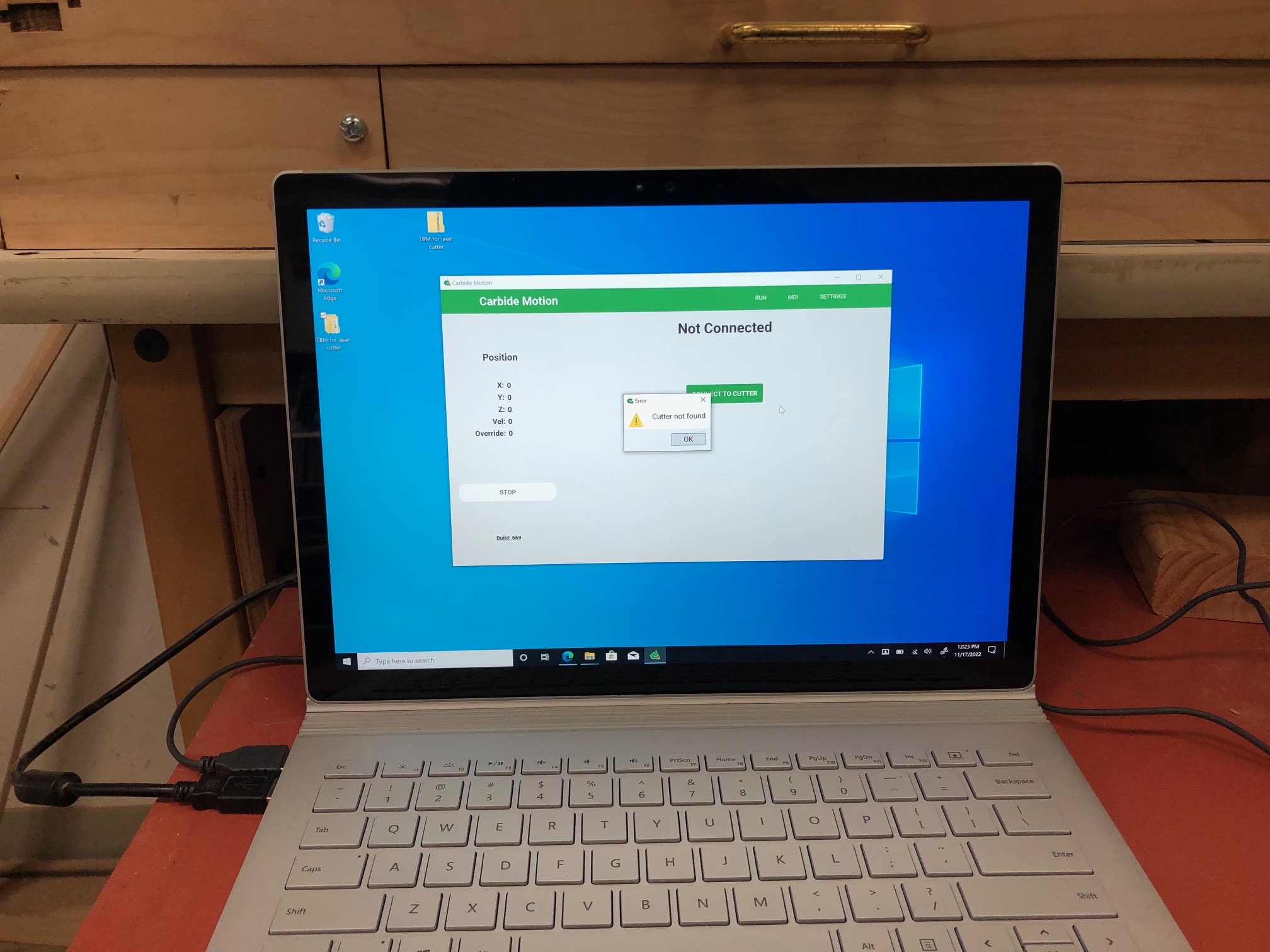

Hello Jay,
Is there a convenient time to find you at the DMS? I think that I just missed you.
I don’t mean to inconvenience you, but I seem to be running into the same issue. I suspect that I am simply missing a step and will need your guidance.
I have attached a picture of the issue to this post.
The Shapeoko doesn’t seem to be connecting to the laptop.
That appears to be the Shapeoko that belongs in Woodshop from what I can tell. If I’m not mistaken they use different software but @jphelps can confirm.
That’s correct, Carbide Motion is for the Shapeoko 3 XXL in Plastics only.
If you have a gcode file you can load it into Easel and send it to the Shapeoko 2 or use some other program, like Universal G-Code Sender or CNCjs to name 2 other common choices.
Yes. The software was the issue. I fot it to work now. Thank you for your attention to this.
