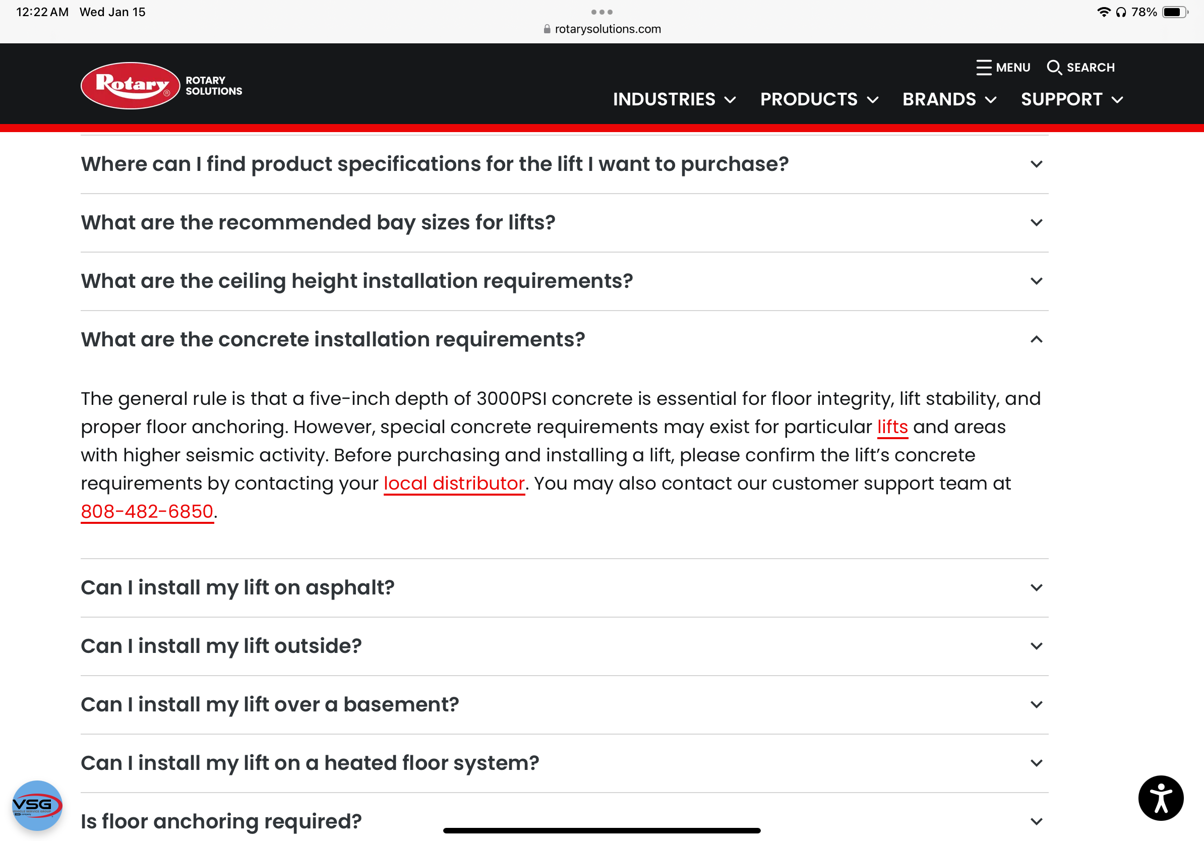

How thick does it need to be for this use case? I’m guessing there’s a number from the manual or something?
Depends on the manufacturer/model.
Bendpack has an outline of specifications including their recommended retrofit pad specs.

The original drawings of the building spec 5” concrete with #3 rebar on 18” CTC
Here is what Bendpak calls for.
Rotary spec
Then there are other Manufacturers that run the gamut of thickness.
