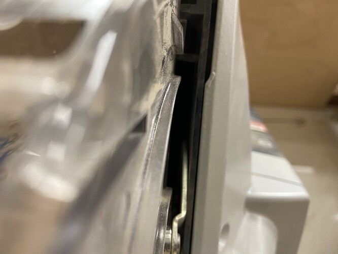

@SWA I don’t see the issue you’re describing. To me it looks like the safety pin is not moving enough when the primary switch is engaged.
In the first picture here you can see the safety pin is in the protected position, preventing the guard from moving:
In the second photo here, the switch inside the finger guard has been activated and this pin has moved, but not enough to allow the guard to pass by:
To me it looks like the armature between the switch and this pin needs to be adjusted? I don’t see anything that’s bent on here. Help me out?
The clear plastic guard had mushroomed slightly due to pressing into the safety pin repeatedly. I lightly filed it back into shape and this should be fixed.
@swa can you show me what you mean about a bent part? That must be a separate issue?

The metal roller on the arm was having trouble getting over the hump. This is common on kapex saws that get heavy use. It was never bent. The arm was lubricated a few days ago as per festool service recommendations. This, in addition to what Ian did yesterday, clearing the path of the blade guard rotation, has solved the issue. I’m not sure if you were referring to me when you mentioned that another member said to “just pull down harder, not a big deal” or not. That was never said. I explained to you, and the member who was trying to cut some wood, what was occurring with the arm and roller, and that you had to pull the head down in a forward downward angle in order to get the roller to clear the hump. You are mistaken if you think in any way that I would have encouraged damaging use of a machine. I don’t appreciate having to spend my time explaining myself on talk either. Does heavy use and abuse of the Kapex happen? Yes. Probably every single day. But not by me. So next time you feel like complaining on talk, make sure it’s not about one of the members who cares most about the well being of the tools.
