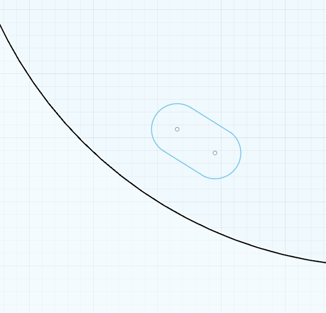

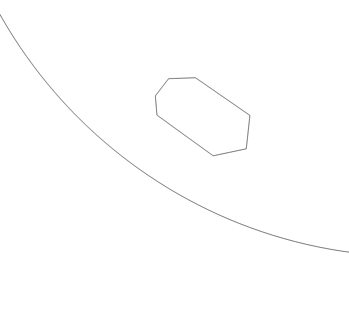

This is the feature that Carbide Create sees:

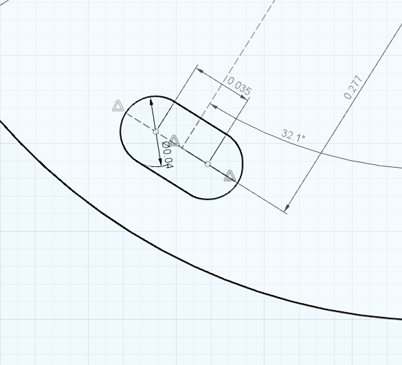

This is the feature that F360 created (ignore any size difference):

I don’t think it’s a size issue. I think it’s either a dxf or a CC artifact. I imported my dxf into Inkscape, saved it as svg, then imported the svg into Carbide Create. It fixed all those problems.

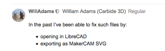

Not to necro this thread, but I believe I’ve found the solution on the Carbide Create Forum. It works perfectly.
Summary:
  • Right click on the fusion sketch in the Fusion browser
  • Export as .dxf
  • Open that .dxf in LibreCAD
  • Export as MakerCAM SVG
  • Import that .svg into CarbideCreate
