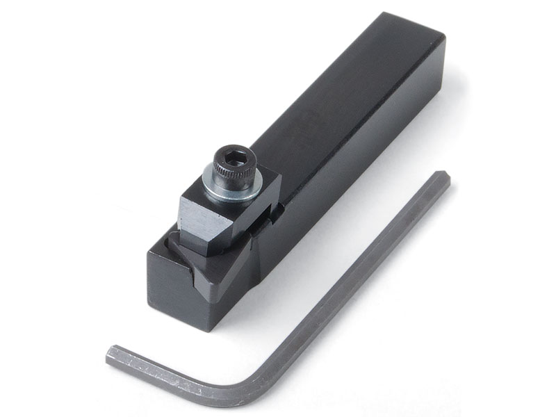

As those of you who have taken my lathe classes know, I don’t think our carbide insert tooling is the best choice for our members. There only real advantage is that they don’t require learning the skill of grinding your own lathe tools from HSS tool bits.
BUT if you choose to do so (which I encourage) or decide to purchase holders for HSS inserts (which are more expensive then the Carbide inserts we use), then I suggest purchasing your own tool holders. This allows you to set the tool bit height and use a quick change tool post the way they are intended.
Our tool post uses BXA style holders, and you can purchase Chinese versions (which are what the space has) for as little and $18 each. Here is where I have purchased mine:
If you do nothing else, I suggest purchasing cut-off blades (HSS) suitable for use on a lathe our size.
Which can use blades like this; http://www.shars.com/products/cutting/tool-bits/p2n-p-type-hss-cut-off-blade
You can also purchase these cut off blades from CDC above.
Noob question here: Given that the old lathe may be going away, are these tool holders compatible with the new lathe?
Yes, these toolholders, and the spaces Quick Change tool post are style BXA, which means they are suitable for any lathe with a 12"-15" throw. The new lathe is basically the same size as the old lathe, so they should work fine.
