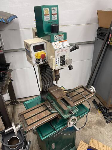

I started with a Grizzly G0704 with the intention of doing the CNC conversion but lucked into a Grizzly G0761 that is considerably more powerful and more capable machine. I do plan on doing a CNC conversion to it sometime next year. There are readily available conversion kits and parts for the G0704 but not for the G0761 that are turn key.
I know some of the smaller CNC routers can do steel but you must go very slow and take lots of small passes. The G0704 can machine steel but you must go slow. The G0761 can run larger tooling and take more material in a pass.
I am currently in the process of getting everything setup to start making parts on my G0761 mill. The tooling and accessories cost more than the mill. Some of the first projects will be making the parts to convert it to CNC.

So the 761 is the one that would be more reliable for steel cutting? Looking at the dimensions that would be able to fit in a van for sure. This machine would need to be converted to cnc though?
The G0704 is around 250 pounds. The G0761 is well over 700 pounds. Helps having an 2-ton engine hoist and lifting straps… If you crank the head down on the G0761 it is about 4 feet tall.
There is not a simple off the shelf drop in CNC conversion kit for the G0761 that I have found at this time. Some of the parts needed are available from different sources though.
