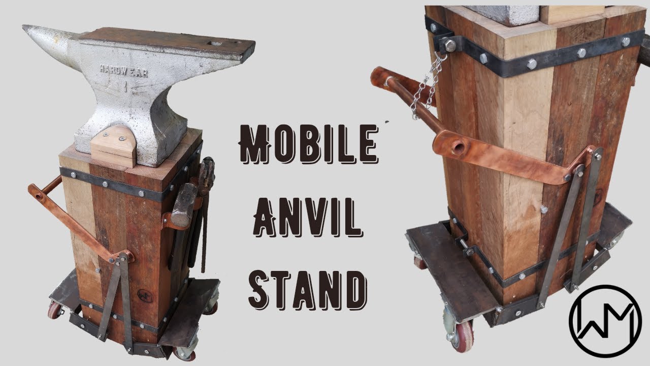

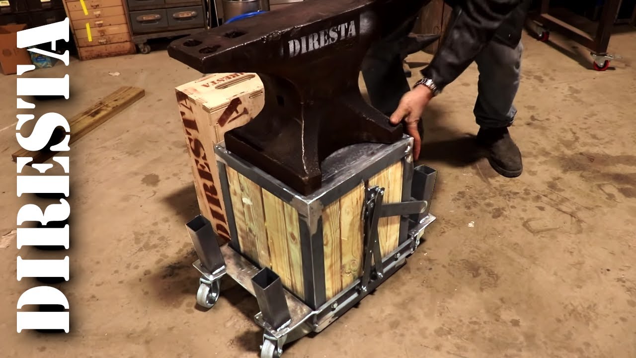

If lifting/moving the anvil around is not an option, consider a clever wheel system for the anvil/stand. DMS uses a simple dolly-style wheel system on one anvil. Jimmy Diresta as a more clever (and more involved) 4-wheel system.
Here’s another, more detailed take on the same idea:
