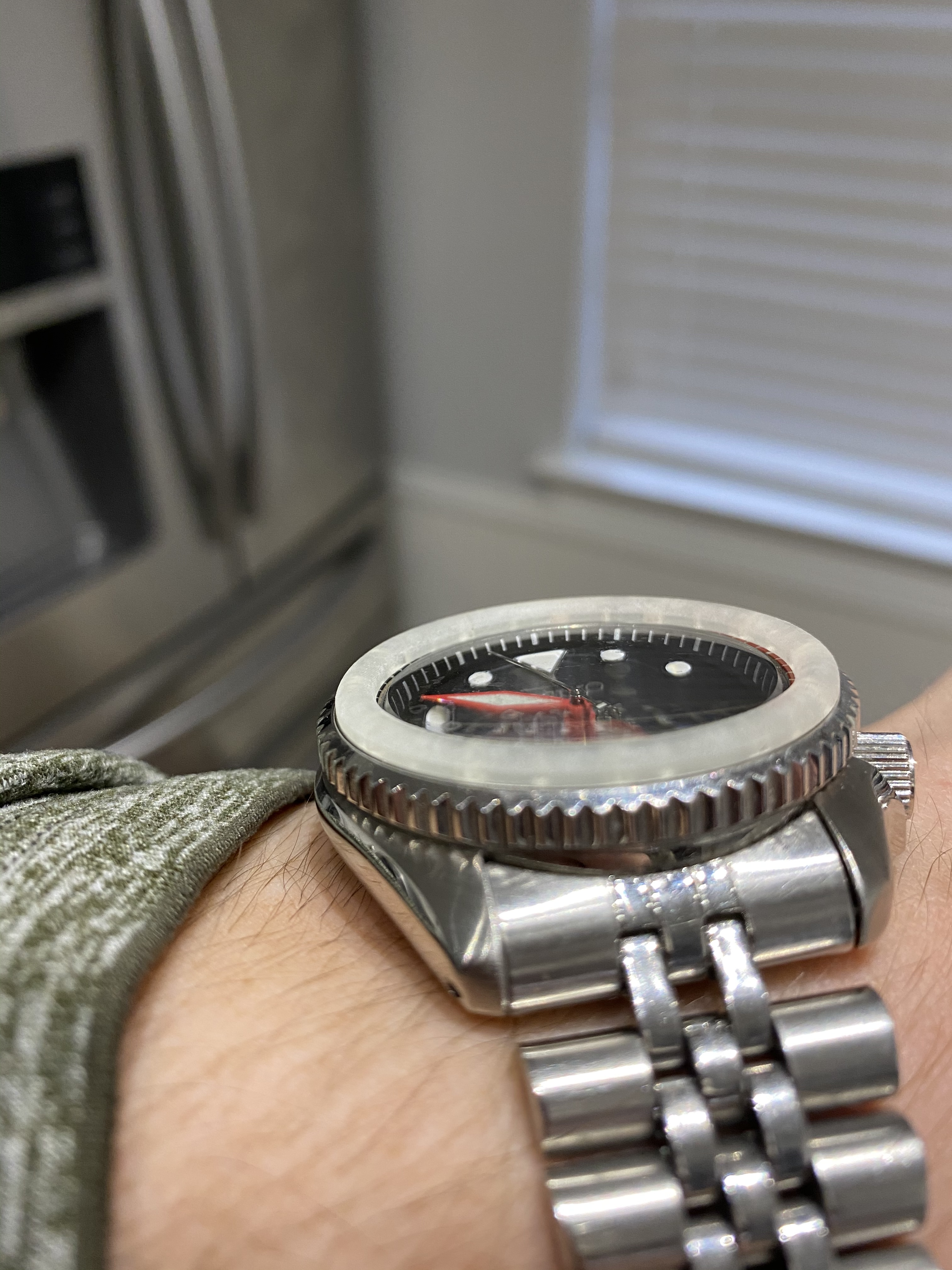

Hello,
I am currently trying to make a silicone mold for a bezel insert I 3D printed. I will be pouring resin into the mold to make a “glass like” bezel insert.
When I started making the 2 part mold I used the Dupont silicone lubricant spray as a releasing agent. It did not work at all.
I was wondering what works best. I was considering using petroleum jelly but I hear it leaves a less than desirable finish. Any recommendations?
