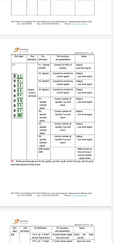

Ok having a look, the spindles are on a pneumatic slider and activates the spindle when fired down, the on/off is controlled by one output.

The wiring is correct, the spindles will switch between tools, and turn (but not at full RPM). I get the impression that there is a setting that I’m missing (communication between the RichAutoA15 controller and the Delta VFD-M).
I don’t know if they are communicating with modus serial or analog input. It could be the delta vfd parameters limiting spindle speed maybe?
