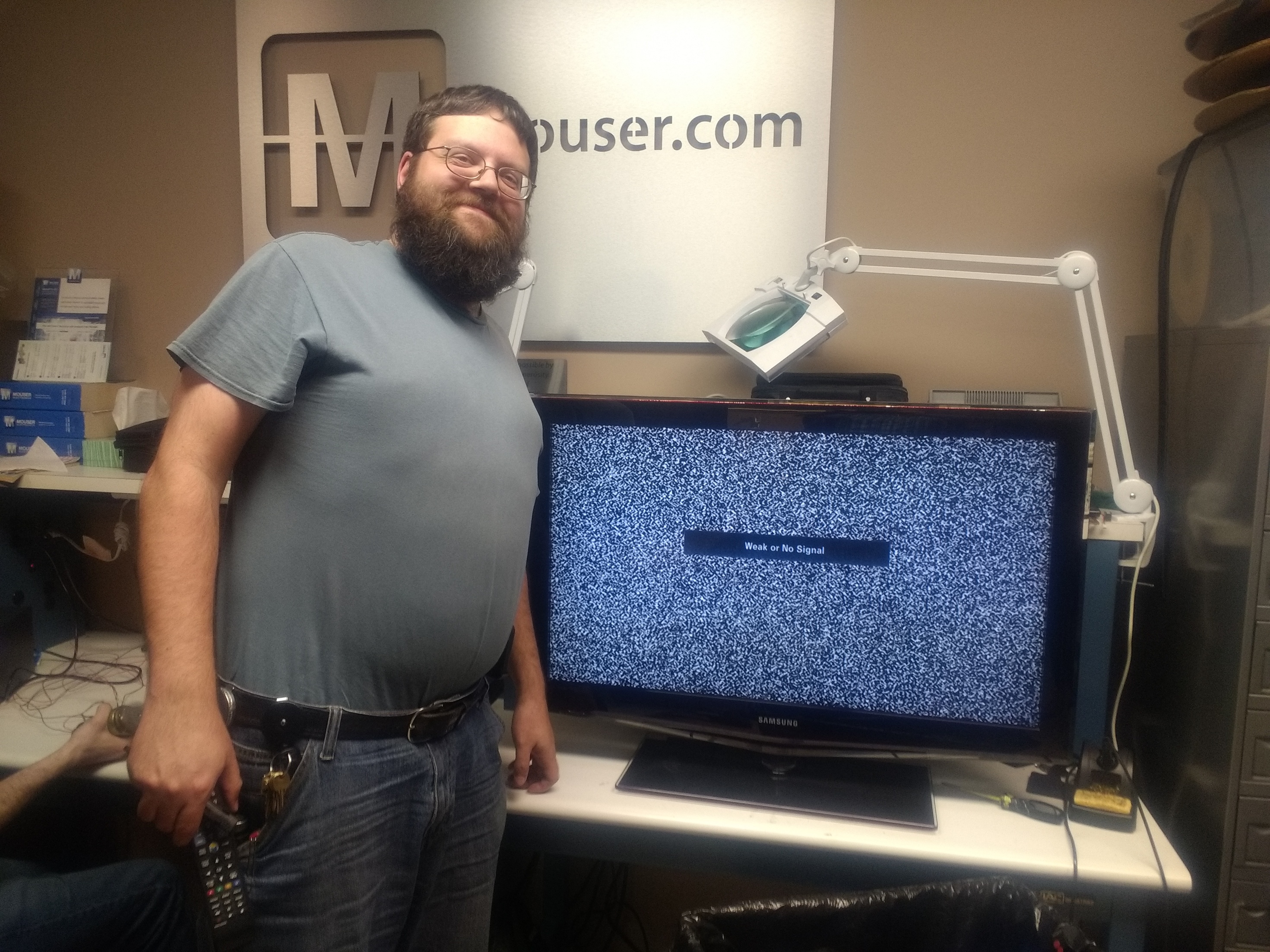

I brought at 37" TV and another member brought a monitor. Unfortunately I didn’t get to help him with the monitor he brought and would like to connect back to see it again. The TV I brought ended up having good caps but 4 of the 6 pins on a regulator chip had solder joints cracked so bad you could wiggle the pins with your fingernail. After resoldering those and a few other suspect joints, the TV fired right up.
I held 4 fingers up behind my back and the closest to guessing the number was Shawn Christian who took the repaired TV home.

Shawn was one of the walk-ins. He, Kelly, and Larry stayed to see if the TV was fixable so the give-away was between them.
