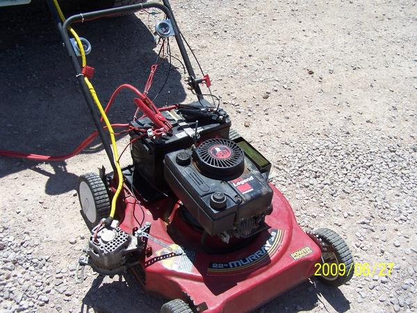

I might be handing someone a business idea, but here goes - consider tossing me a decent thank you gift if you can make it work and get rich. A general idea of what I’m thinking of:
That particular setup is probably just an automotive alternator connected to the shaft by a pulley; appears to be reversible so long as you can suffer the anchor points in the deck.
Now imagine something similar that uses clamps maintain its position on the discharge port, has some means of tensioning the pulley so as to be widely compatible with a variety of mowers, and has an actual ~1kW generator attached. Setting it up is probably just a 15 minute job that’s only a little more involved than a blade change.
