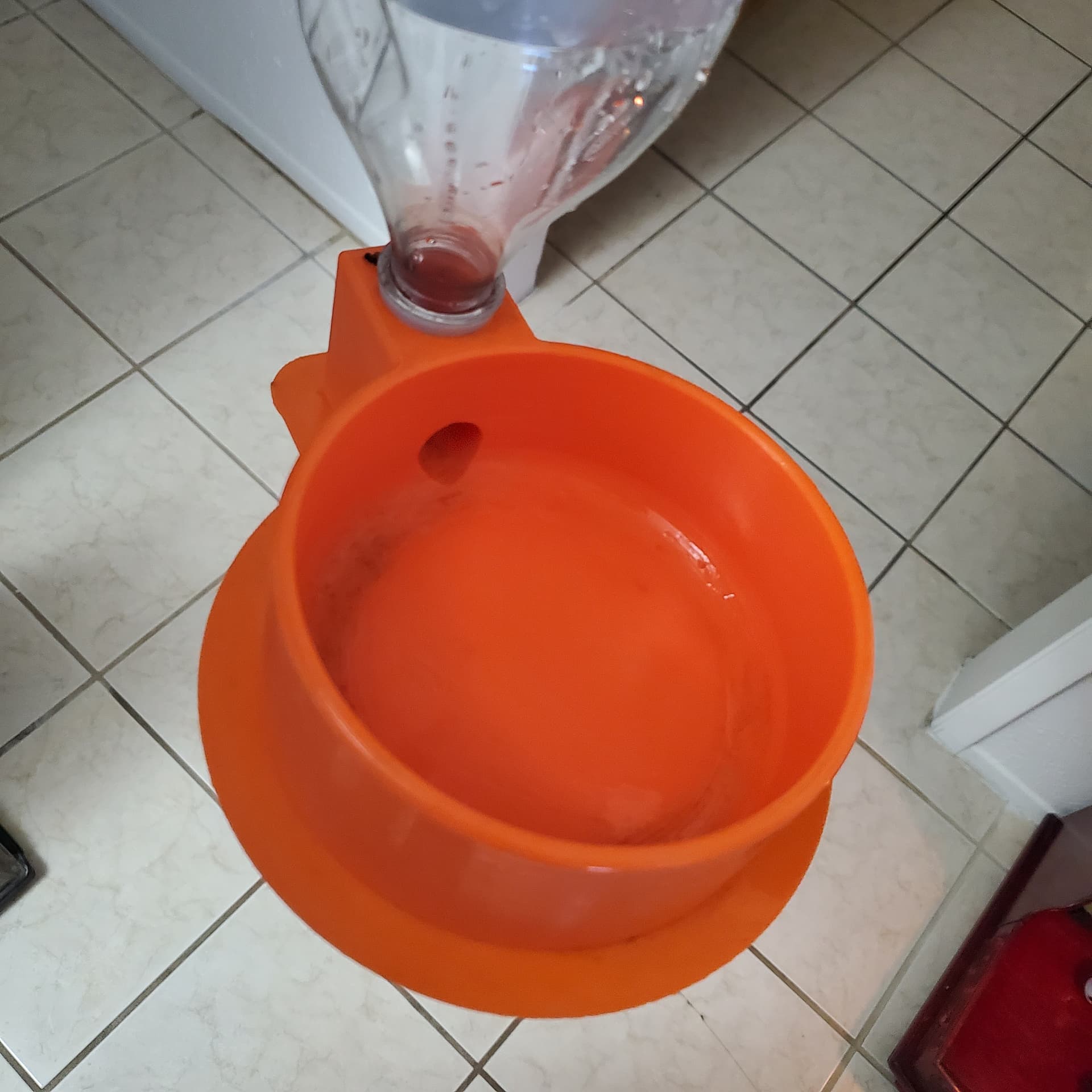

Apply this same principle
but perhaps with a tube attached to the bottle to feed the 'hole.
Gist: when the water pressure in the lower vessel is low enough for the vacuum in the upper vessel to draw air, water is allowed into the lower vessel in equal volume, so they stay in equilibrium (within a range).
Many variations on the animal-waterer have been used over the years, this was just a cute story about one.
Perfect!
And just use a one or two liter soda bottle and a 3D printed adapter so we can feed a small hose and get the bottle up where it’s visible. .
