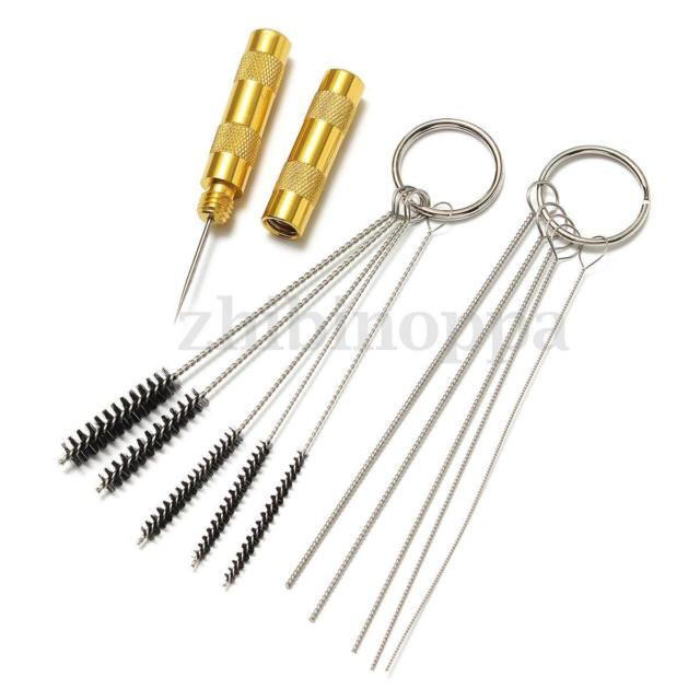

In my experience, airbrush clogs typically come down to improper thinning and too much pressure. I’m not familiar with the brushes CA has, or the paints that have been run through them, but it’s probably a good idea at this point to tear them all down and give them a proper cleaning. Ultrasonic baths are nice, but a good brush set and some solvent will take care of things.
What type of brushes are CA using? What kinds of paints are typically used?
We have brushes, nozzle picks, and plenty of stuff for cleaning them.
Currently we have 6 gravity fed double action airbrush kits from Master, only because they would be well loved.
Typically they work well enough to get a taste for airbrushing so that folks can then be encouraged to purchase their own, better quality airbrushes.
Edit: currently we are only using acrylic ā€˜airbrush’ paints, though the ones we have are not high quality. Just for learning really.

I got my start on a Master G23 many moons ago. It’s a decent brush, the only real problem is the seal quality.
What brand of acrylic paint are you using? I’ve had nothing but good experience with Tamiya’s line of acrylic paints in both my Master, and my Iwata brush.
We got a pack of ā€œUS Art Supplyā€ with the airbrushes.
I personally use Vallejo, but have also just started trying the paints from Reaper.
Vallejo’s airbrush paints are also top-notch. I use their grey primer on almost everything I point the brush at. But I do think the clogging issues are largely down to poor quality paint and insufficient cleaning. Perhaps some classes are in order to better convey these concerns to new painters?
Yeah, for sure the cheap paints and insufficient (if any) cleaning.
