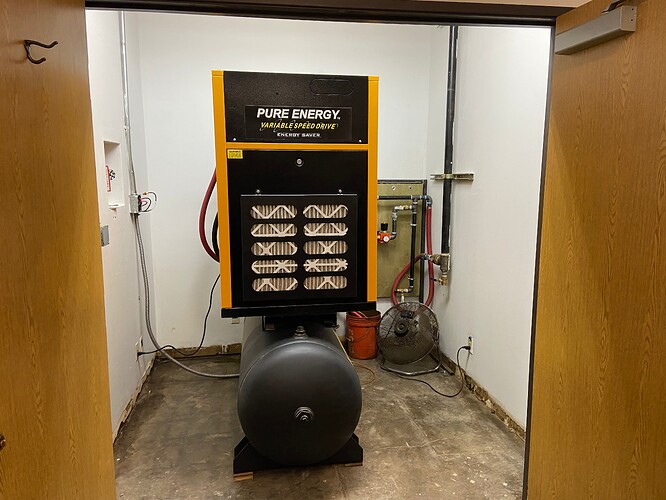

Well all this is fully completed. Thanks to @Paul_Morley, @BobKarnaugh , @Mrholthaus , @artg_dms , @jphelps & @procterc for help getting this done.

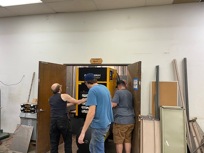

We set the new air compressor outside the room temporarily. We then removed the old air drier, then the old air compressor.
@artg_dms replaced the lights in there. @jphelps replaced the ceiling tiles. We all cleaned the floor & walls. We then painted the room. Turned the temporary setup off & then moved the new wire compressor into the room on my machine skates.
Before

I don’t think i’m exagerating when I say this was the most well executed project I’ve participated in over the years. Wouldn’t have been possible without the great planning by @TBJK as usual.
It was an amazing collaboration of people and skills. It’s so much fun to participate in these sorts of events. It’s easily one of my favorite things to do at DMS. It’s not for everyone but it’s very gratifying to improve the place we all love.
One footnote that may not be so obvious. In the next to the last pic you can spot the metal skates the Tim designed and fabricated. We lowered the compressor onto them and rolled it into place with ease. Was even able to steer them to make the corners etc. I think those skates need to go into the DMS hall of fame!!!. @TBJK, post a couple of pics in this thread it you don’t mind.
