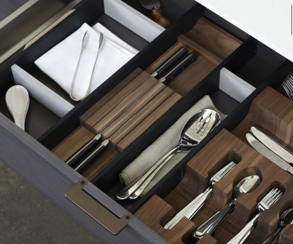

These are pictures of the original inspirations.

Seeing your inspiration, I can confidently say that those are made from at least 2, and probably 3 separate pieces of wood. You can see that the grain on the cove runs perpendicular to the grain on the rest, indicating that they are two separate pieces.
I would also guess that the area below the cove is two separate pieces from the same block, divided at v groove. This makes this piece significantly easier to manufacture. Picture of what I mean attached.
By separating out The middle piece, cutting the blade grooves becomes trivial: full length, partial depth cuts with the table saw at specified intervals. (Think really skinny dados).
You can actually see in the second picture that the cove is a separate movable piece, and In the first picture, the blade holder is a distinct piece of wood with different coloration from the bottom board.
