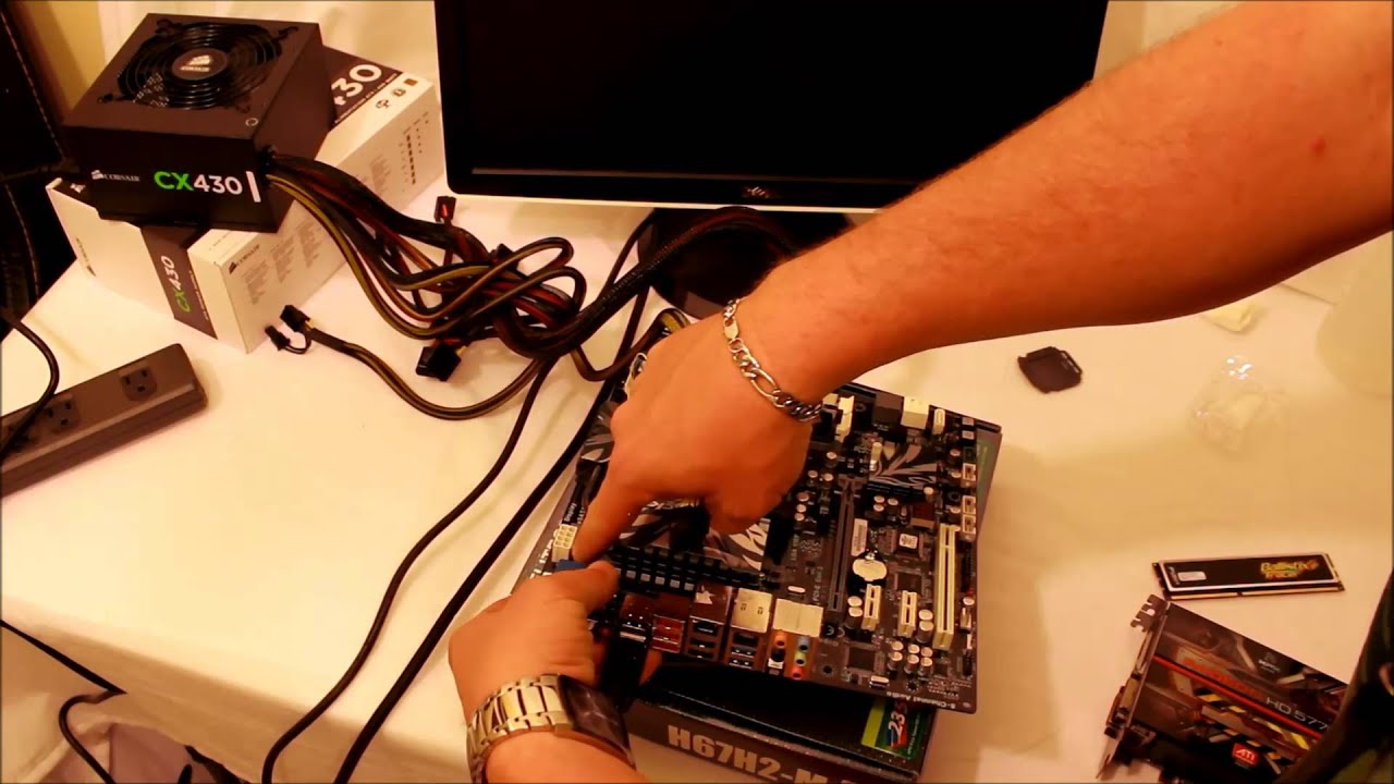

A tip that I see on the internet all the time is to put your mobo on the cardboard box it came in and plug in only what’s necessary to boot. Then once it posts fit everything into the case.
I’ve never felt comfortable doing that myself, but if it’s good enough for Linus… ¯\__(ツ)_/¯
I’d probably bust out an ESD mat and put the board on that, but yeah…
