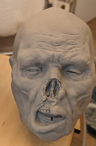

I commissioned some zombie sculpts from an artist on Reddit and they came in today. Planning to do a cavity pour mold of these.
First step is a clay up, which will eventually become the silicone part of the mold. When Reynolds opens on Monday I will go get some epoxy putty to build up an outer mother mold, then remove the clay and pour silicone in via the spout at the top.
Will update with further progress. Besides lifecasting, this is the most advanced mold I’ve made so far
