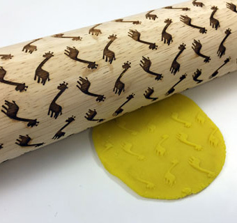

Hmmm…Lasering a rolling pin that does not have any handles, a la:
seems like it could be done on a fairly straight-forward basis with the rotary attachment (maybe depending on length of rolling pin). But if it has handles, it is way more of a challenge and you might consider texturing something flat that could also then be wrapped around and somehow affixed to the rolling pin.
