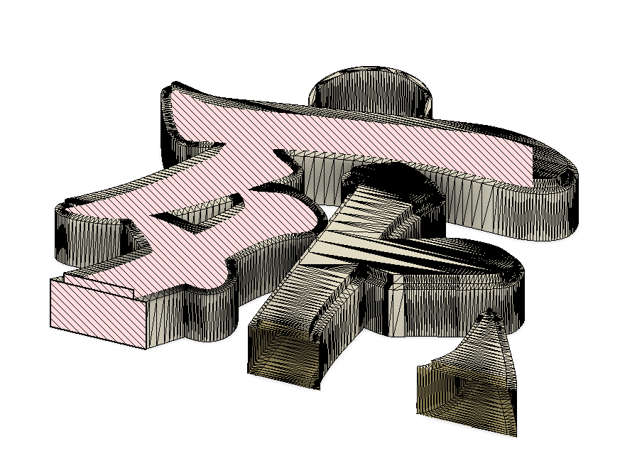

Did you repair the mesh before trying to print it? IDK if this contributed to your problem, but the STL file appears to have some issues:
FWIW, it’s good practice to repair any stl’s you get from someone else before you try to print.
Perhaps someone else can answer this … do we have netfabb or some other stl repair utility?
EDIT: You can see from this cross-section analysis that the character on the RHS is hollow. It has a mathematically infinitesimal shell but nothing else. Not sure that’s repairable - someone with more skills than I have will have to weigh in.
How do you repair mesh? I had a few similar issues with some of my prints in the past, and while I was mostly able to solve them, more skills are always a good thing
Simple repairs are accomplished with netfabb. AFAIK, more complex repairs require going back into the CAD.
I’ve never found a reason to use an automated function to repair stl files. As in this case, the root issue is almost always because of the way that you’ve opened that file – software, settings or whatever.
Editing stl files is a kludge. That feature is most likely there because the importer doesn’t work correctly. in this case there’s no need to do that, as they’ve included the blend files. (free software!)
If it slices and the toolpaths look ok, then there’s no issue (besides the fact that stl format and kissslicer are both janky).
All 3d graphics data is just defining the shell. It doesn’t have any information about what’s inside. The issue is that the mesh doesn’t look watertight according to your software, probably because there are a lot of overlapping faces on the chamfers at the top. I tried superslicer (free software!) and it slices fine.
