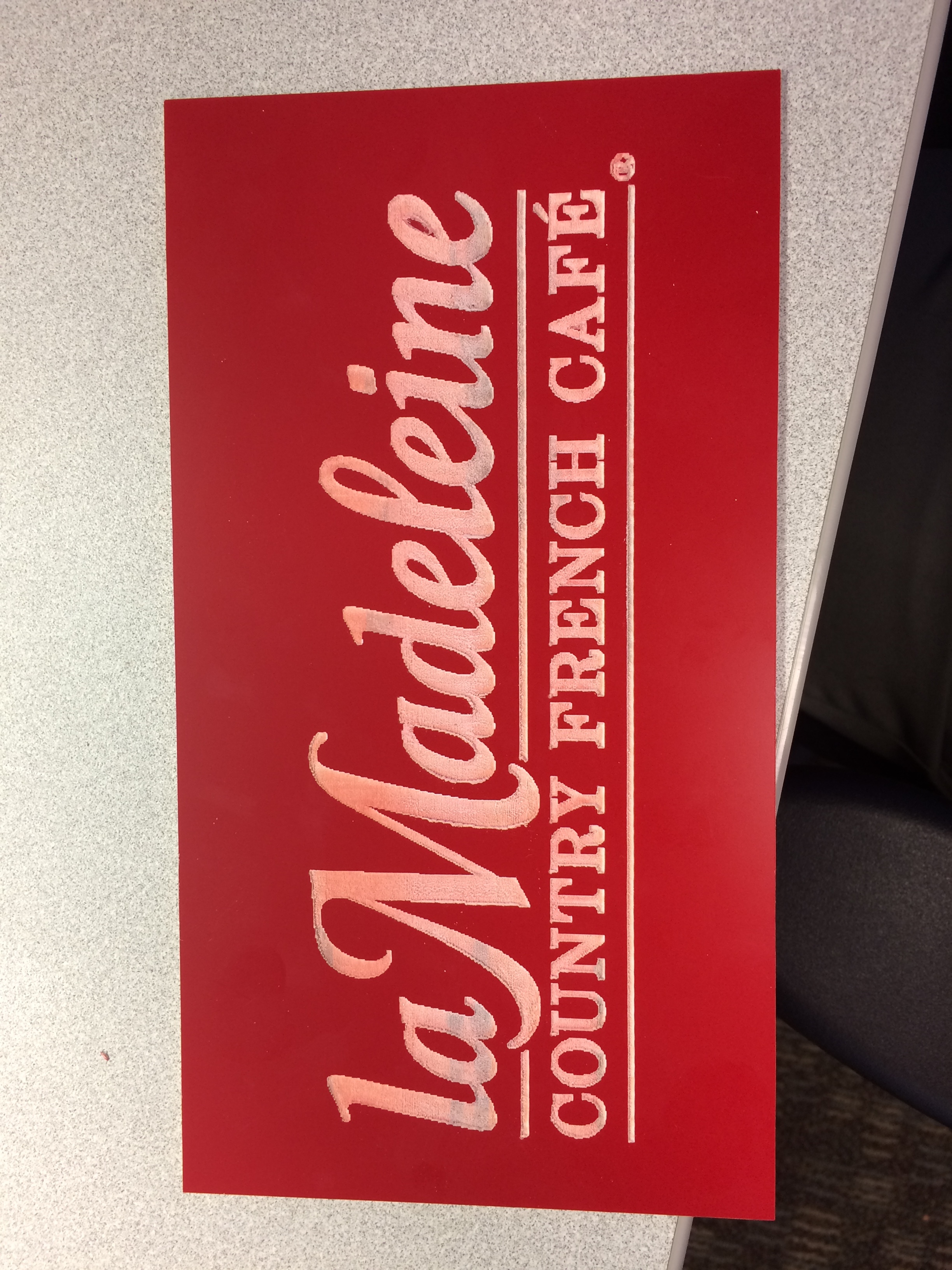

I’ve done my first acrylic rastering on the Thunder. The top red layer and black print from my protective sheeting is bleeding into my bottom white layer. Can anyone give me advise on how to prevent this? I played with varying speed and power settings, but it basically came out the same regardless.

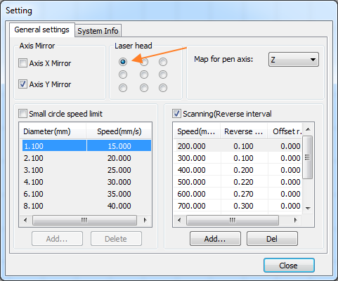

Under Main Menu>Config(S)>System Setting
the Default is to have the Laser Head Anchored in the upper Left.

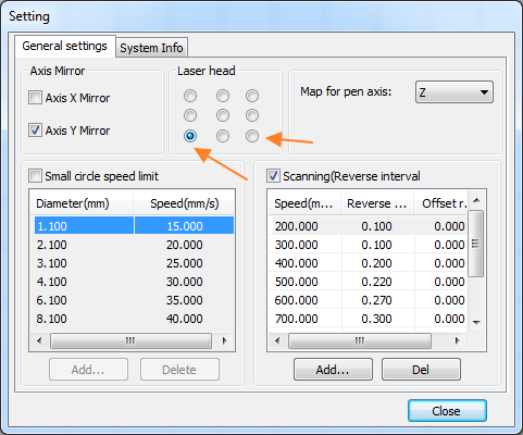

To have it Raster bottom up, you need to change the laser head (and thus Anchor Point) to either the lower left or lower right. (I am not sure which is better)
Be sure to choose Anchor Point for your position.
2 notes.
  1. Your Frame will be different, starting from the new position and moving up.
  2. Please reset to the original position for the next user. These settings seem to travel about.
Let me know please if this works for you.

That setting did work for reversing the direction; however, it did not help the top color of my 2 layer acrylic bleeding into the bottom layer.
That’s a bummer. Did you try 2 passes as Cary does? Ideally, the second would vaporize the bleed.
If you leave me some test material, I’ll work on it this weekend.
I did try two passes, didn’t really work.
