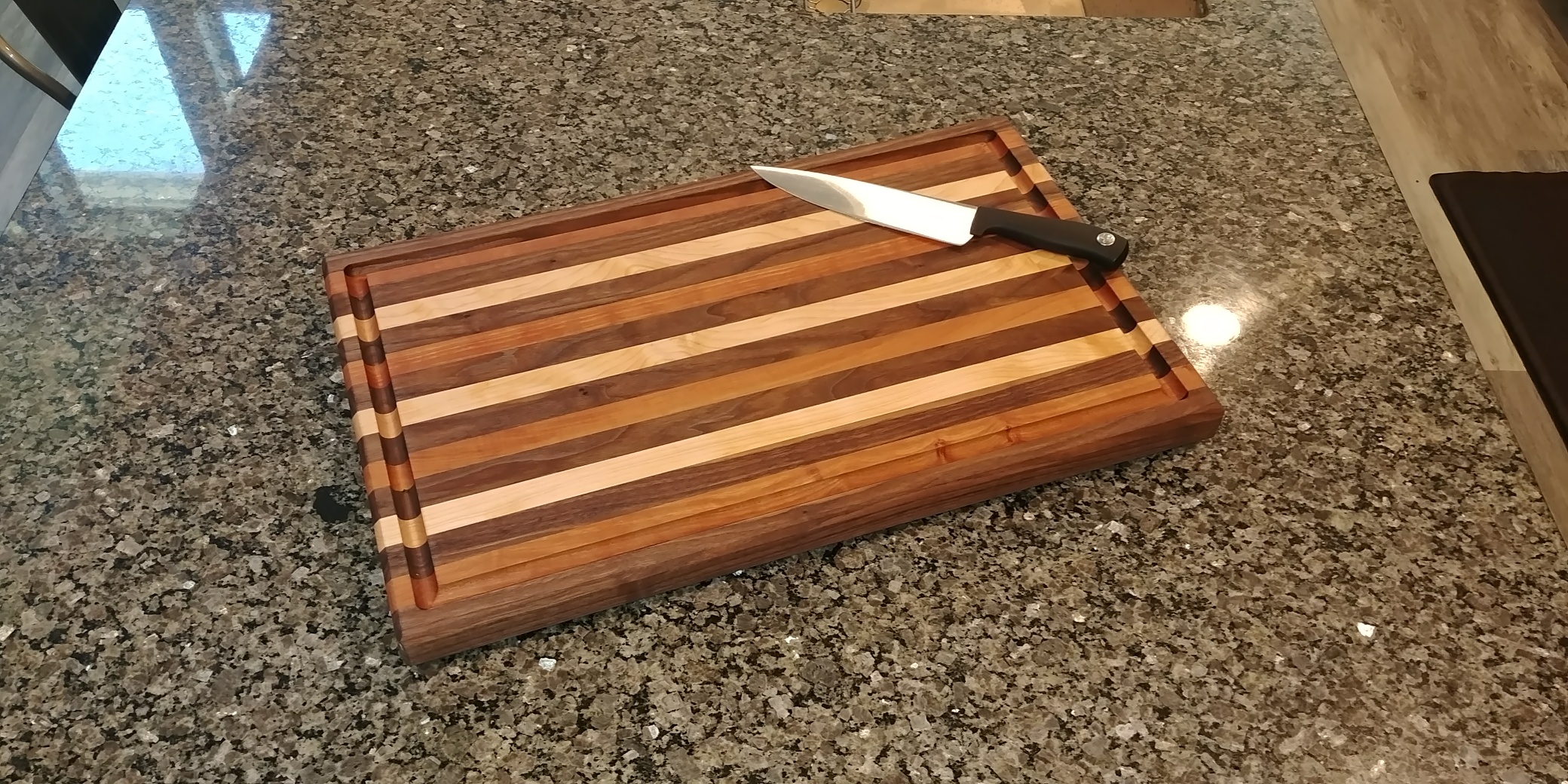

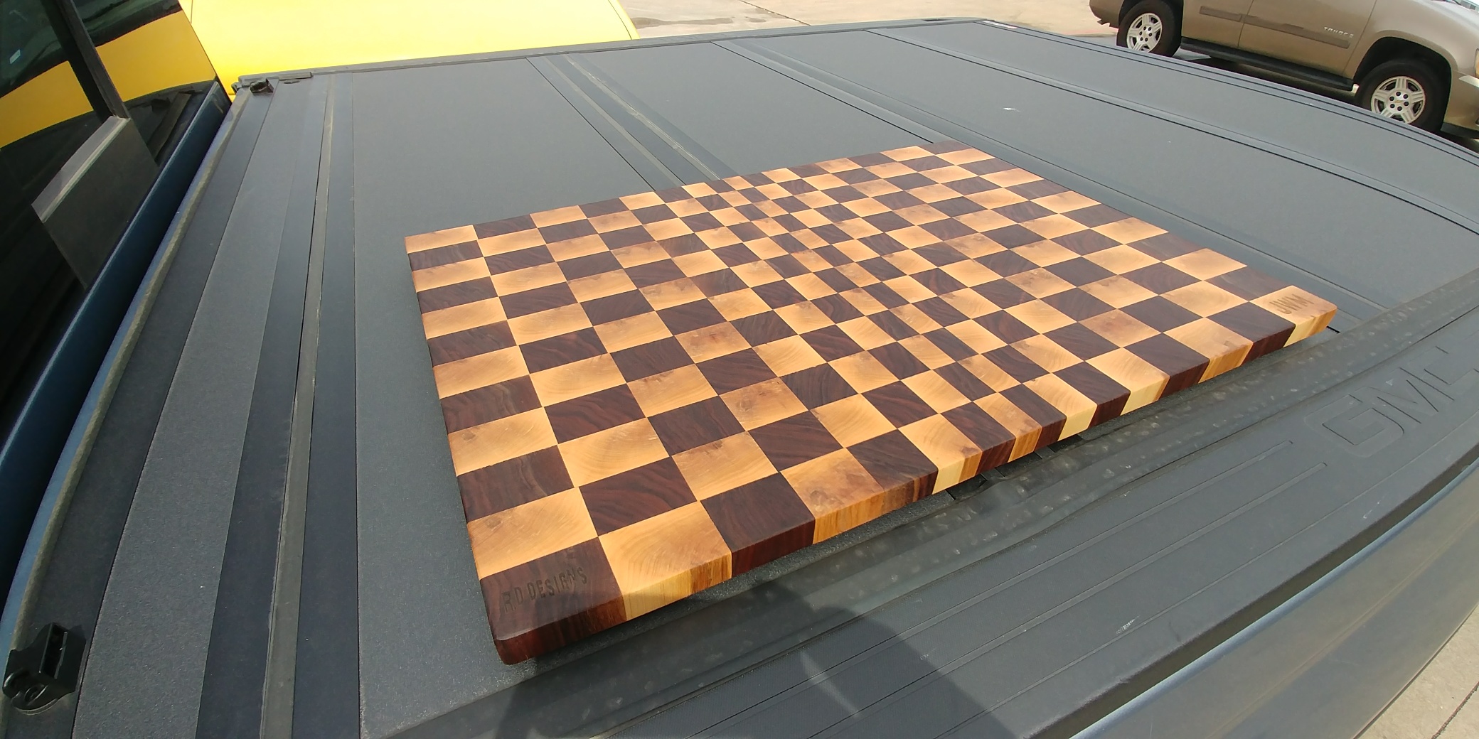

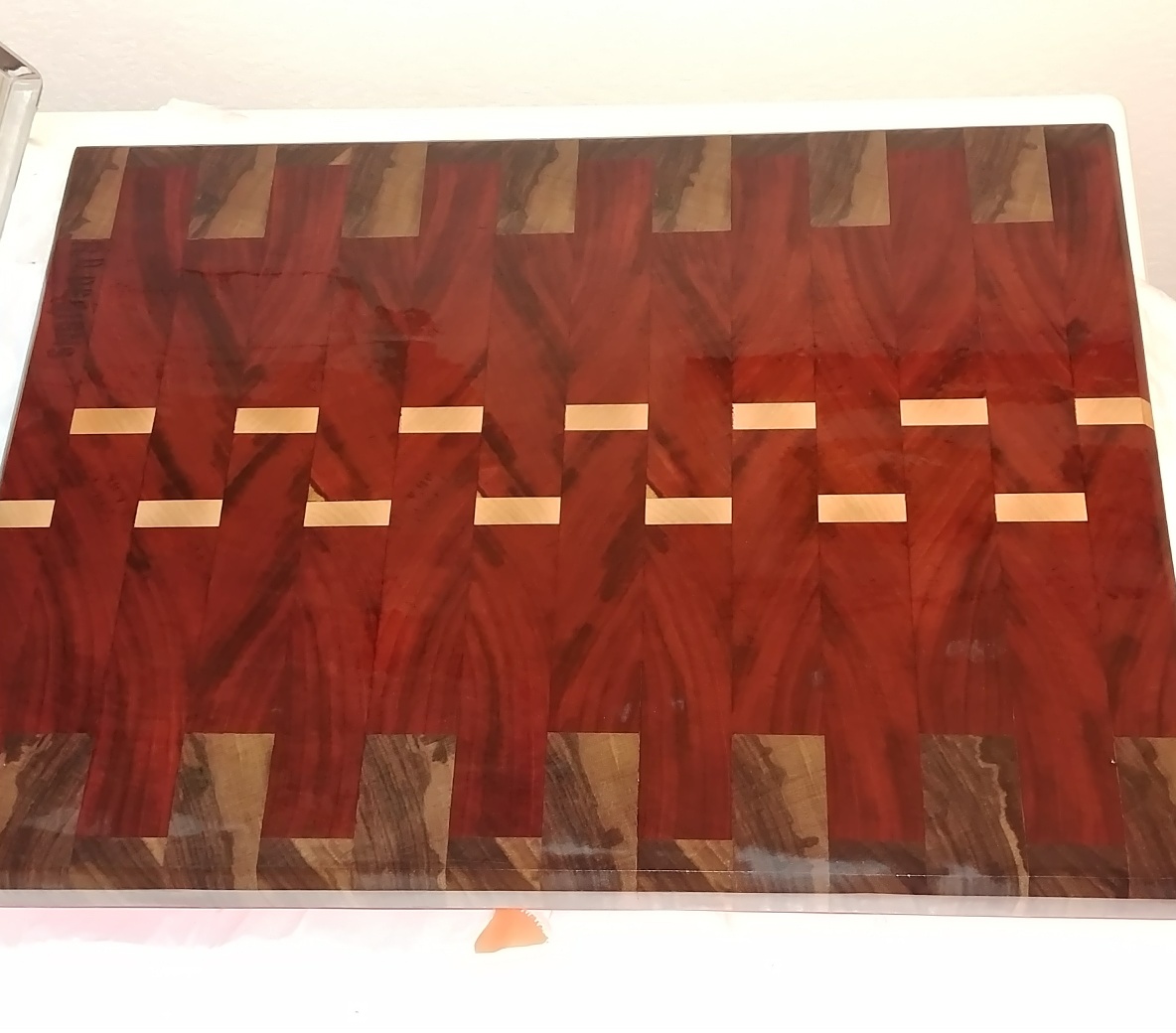

End-grain versus Edge grain: Edge grain just requires one glue up. End grain requires a second glue up and therefore woudl require an extra class.
Session 1- Squaring up stock, cutting to size, layout, and glue-up. I would come back the next day to remove the clamps and store the wood. People would have the option to do finishing sanding on their own or we can have another sessions on finishing. This is if we doing edge-grain.
Session 2- If doing an endgrain we will plane/sand the initial glue-up, then make the new cuts and do the secondary glue up. If edge grain we can do finishing in this class. If doing end-grain we would need to get together for a 3rd session to do finishing.
Wood options- I would think I would have two options, bring your own wood, or pre-pay and I’ll pick up wood from Central Hardwoods for anyone interested.
Give me your thoughts. I attached a few pictures, showing an edge grain board and a few end grain.

I’d be interested in either. Having no good reference for the cost of good wood, how much would the wood for something like the checkerboard one run someone?

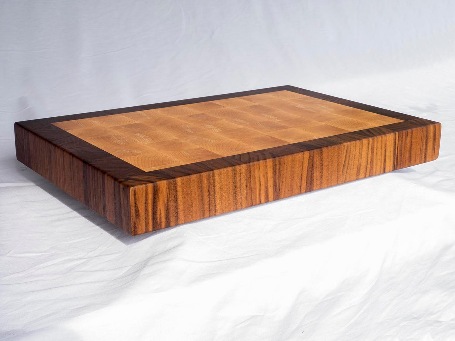

The way I am currently thinking/planning will be under $30 of wood per person. It would make an 18"x12"x1.5" board.
To simplify the first time through class (it will be my first time teaching at DMS) I am thinking of an end grain maple board with a walnut border. I can prep the wood some before class and know we are all working with the same size and quality of wood.
If it goes well I’ll do another class on a checkerboard style.
:+1: I actually prefer what you’re describing over the checkboard it was just the easier one to describe :slight_smile: and the one I see a lot of people attempting around the space. Thanks for the info

I am discussing logistics with a few seasoned woodshop members and will be posting the class once I have the details nailed down. To make this easier on me the first time around I am going to buy all the wood and have class members pay me back. It will be end grain and we will all make a board like the below picture. Once I have taught the class cycle and feel more comfortable with the flow of the class I will open up another series to do more custom designs.

You’ll still use the jointer and planer on the length of your boards, then glue up, then cut to the end-grain, the glue those up, then drum sand. It’s really only 2 extra steps for end-grain.
