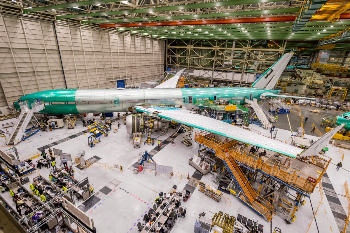

The only thing the 777 they have a pic of in PM is that the hinge mechanism at the tips is a candidate for the folding part of the concept wings. They’re VERY long, so will have to fold - nearly in half - to fit into existing gates and such.
