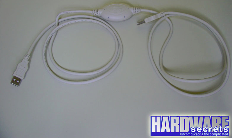

I’ve always thought a cable directly from one computer to another computer was pretty secure.
