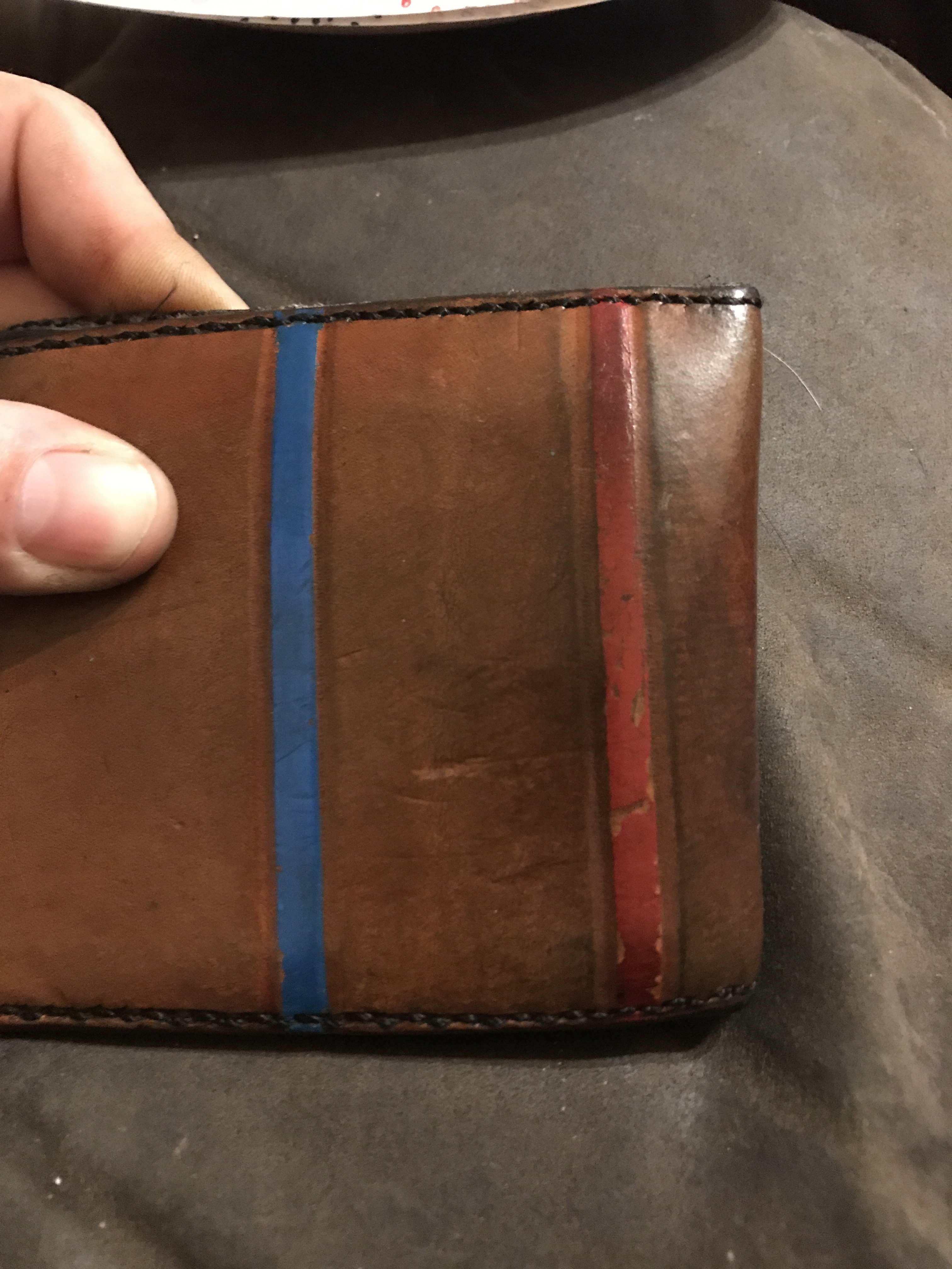

I did just that when I made my leather MTG pack holders.
For the detail piece, I lasered it with blue tape on top, removed the tape where the symbol is, and then very gently applied some purple with a q-tip where the blue tape was removed. You want to use a very small amount of dye to keep it from absorbing under the edge of your stencil.
The lasered area acted like a mask It sealed the leather fibers
